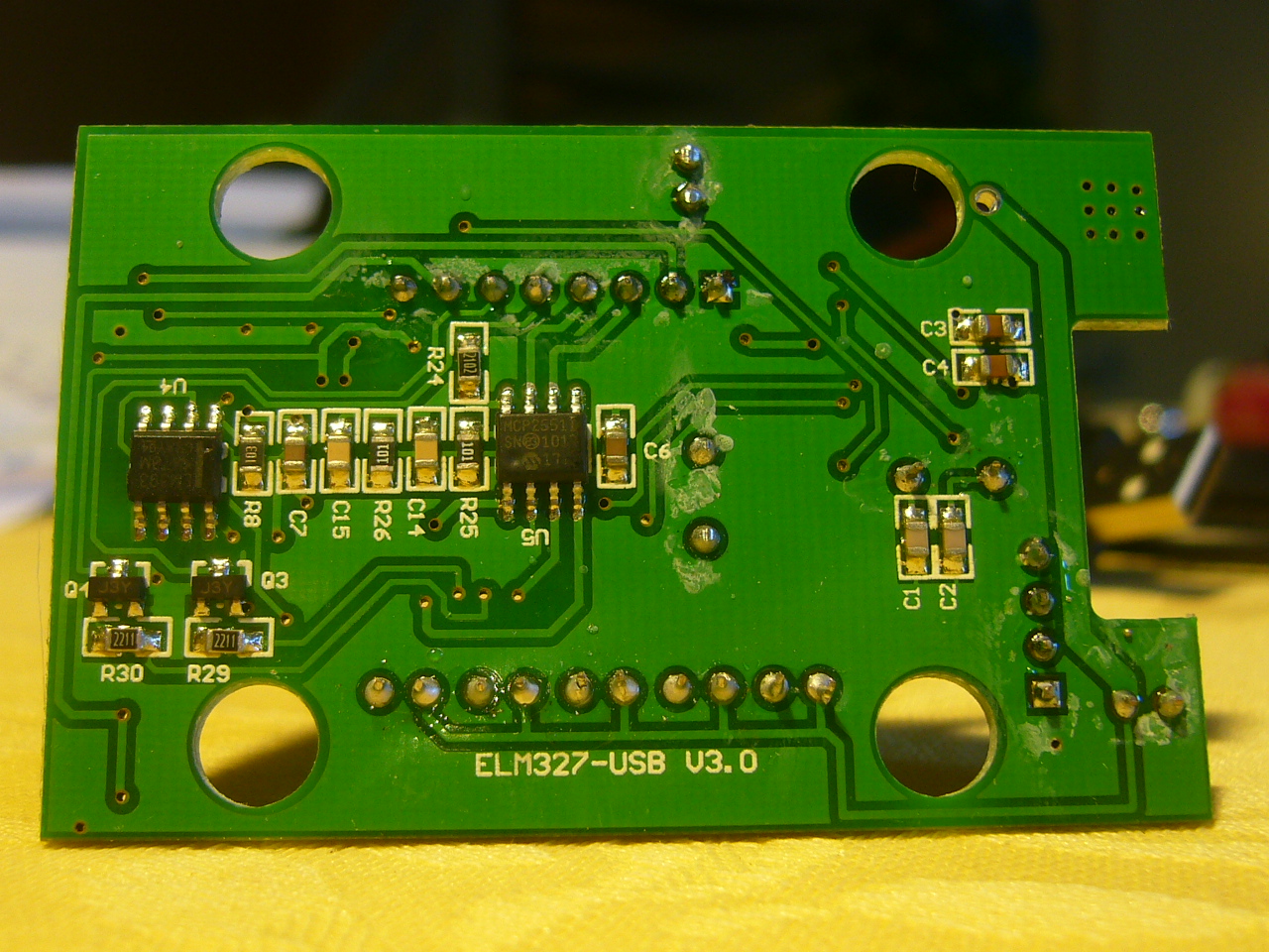

I have this elm 327 1.4a download/file.php?id=238 ,download/file.php?id=239 but when I try to connect to my
FIAT 500 1.3 mjet 75 cv with multiecuscan 282 and do the test I get this error atbi error 94.
What can I do?
I have to throw it away or can I resolve this problem in some mod?

thanks for response.....however I tried the test but the result is always this error ATBI 94....
I read in this forum that some people have solved the problem removing a resistor (R4 or R25/26) from the interface and add another 120 ohm and 560 pf between 6 and 14 pin
Is possible on my type of interface or I have to buy another ???

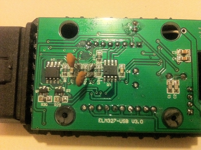

Re: elm 1.4a no connect
If you try to connect to a can ecu or to the body,
maybe you have a foulty interface...
you have to change c14 and c15 capacitors that are wrong value.. change with 2 new one of 560pf value..
If you have problem, ask to me!!
Is ok ?
puo andar bene o ho fatto una vaccata?
- 2.jpg (166.18 KiB) Viewed 7792 times
Sembra andar bene..Piranha666 wrote:Is ok ?
I condensatori sono nuovi sono giusti?? Li hai provati con un tester che provi la capacità??
It's look like ok.. but le capacity of the 2 capacitor are ok?? Do you have tested??
