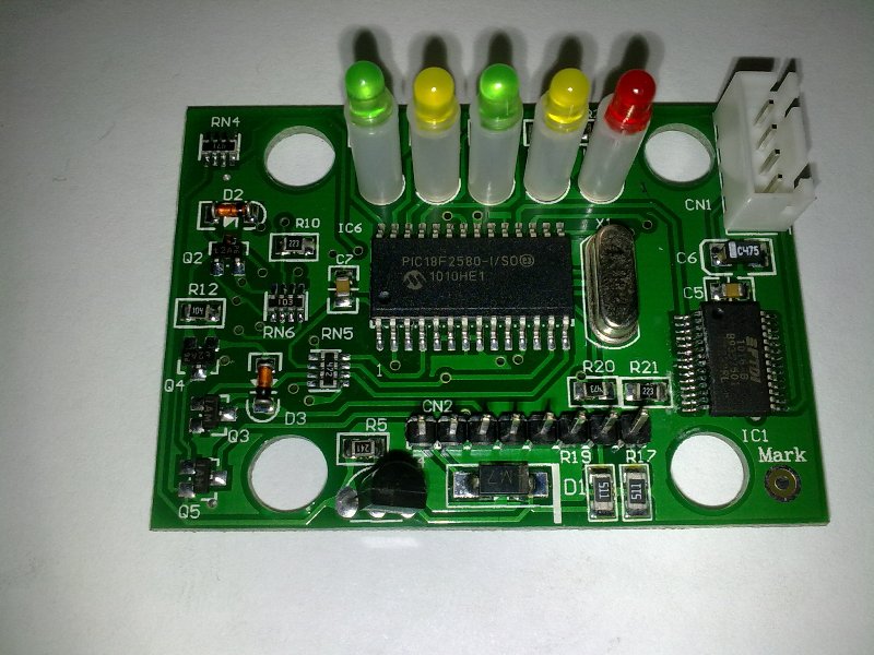

I found a quick and dirty solution:
  • Bought the cheapest ELM327 interface from eBay (actually V1.4)
  • Disassembled and found I had the board below.
  • Using a craft knife I carefully destroyed the 120ohm resistor (R04 on the board). Be careful you don't damage R17 just beneath it.
  • Resembled and it works a treat!

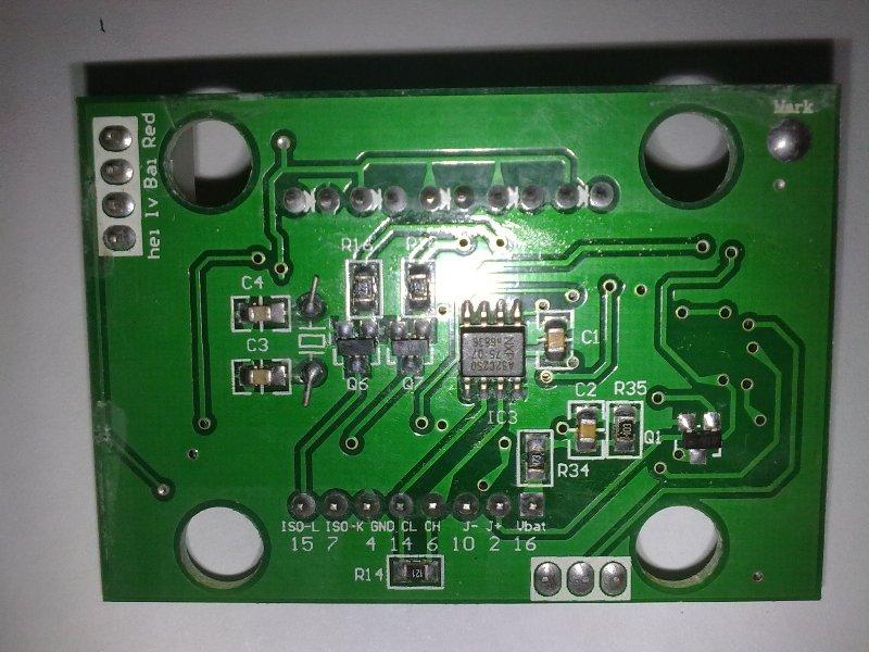

My bad interface looks like this. Not sure which version it is. So, do i need to remove R14 and solder 100 ohm resistor and 560pf capacitor like what 1st post did to cure CAN issue?
yincar
top side
top side
bottom side
bottom side

Post by ivica21 »
Yes.And then your can line will work.

Argo wrote:I found a quick and dirty solution:

My board was lke Argo board and I followed what he did.
I just destroed the capacitor.
It still works with Android phone but does not work with N900.
Can Anybody suggest anything?
Thanks.
Argo
Posts: 6
Joined: 13 Dec 2010, 12:17
Post by Argo »
sam29 wrote: I just destroed the capacitor.
R04 is a resistor :?
Assuming you only destroyed R04 then I'd go ahead with the full mod suggested by Yani at the start of this thread which involves soldering in a simple RC network.
