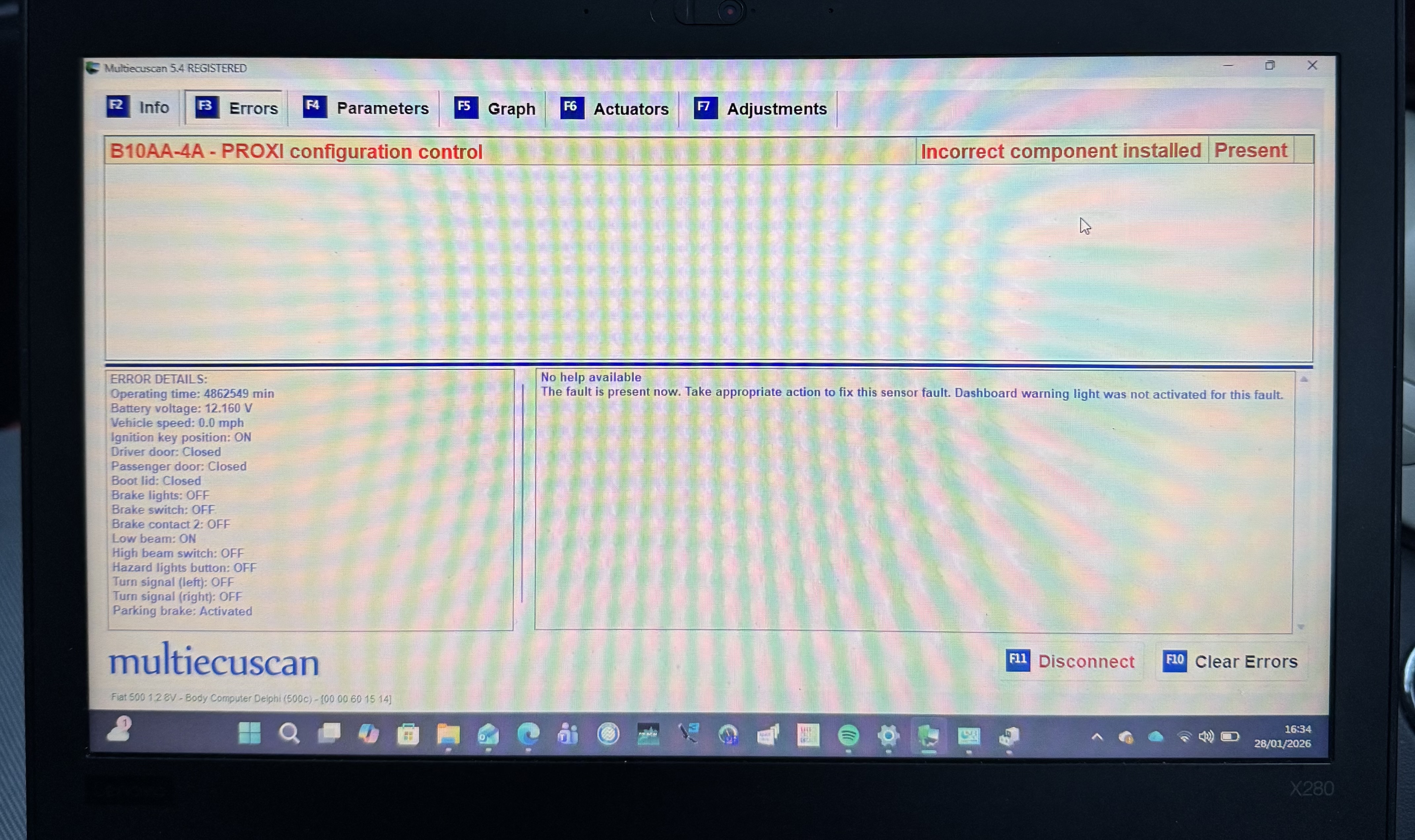

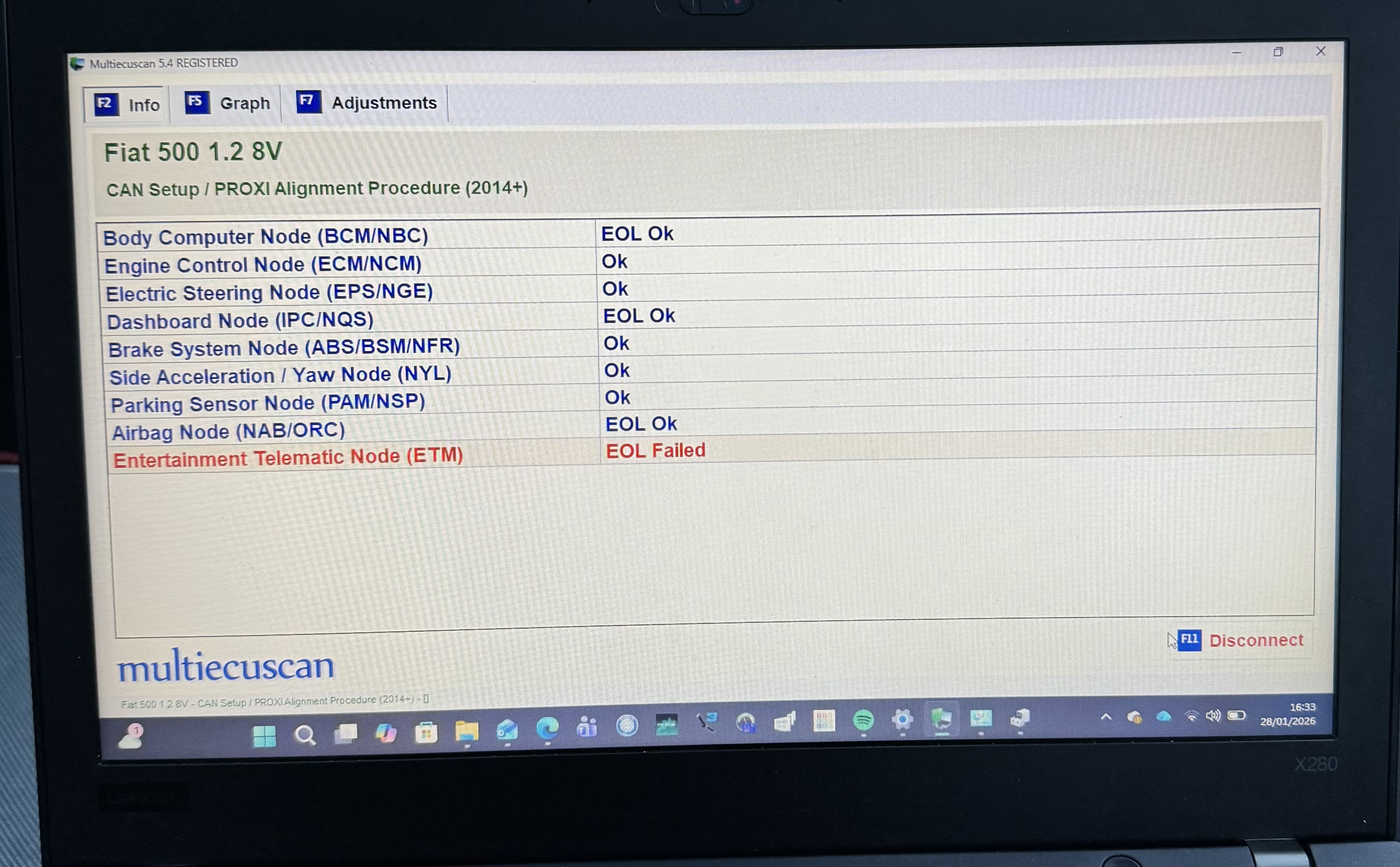

Need some help solving a problem after fitting a 7” unconnect.
I have completed a prox alignment and I’m getting the following error
Entertainment Telematic Node (ETM) EOL Failed
Along with
B10AA-4A - PROXI configuration control Incorrect component installed Present
All features on the unconnect 7” work fine but the mileage flashes
Thanks in advance for some guidance

I had the exact same issue and followed the guide from Step 6 on this page which resolved it:
https://vk2.net/articles/Abarth-UConnect%205-to-7-Upgrade

Thanks for your help, I reading the article and making the changes it suggests seem to have solved the issue I was having. My only question is what’s the significance of increasing to 193 bytes?
