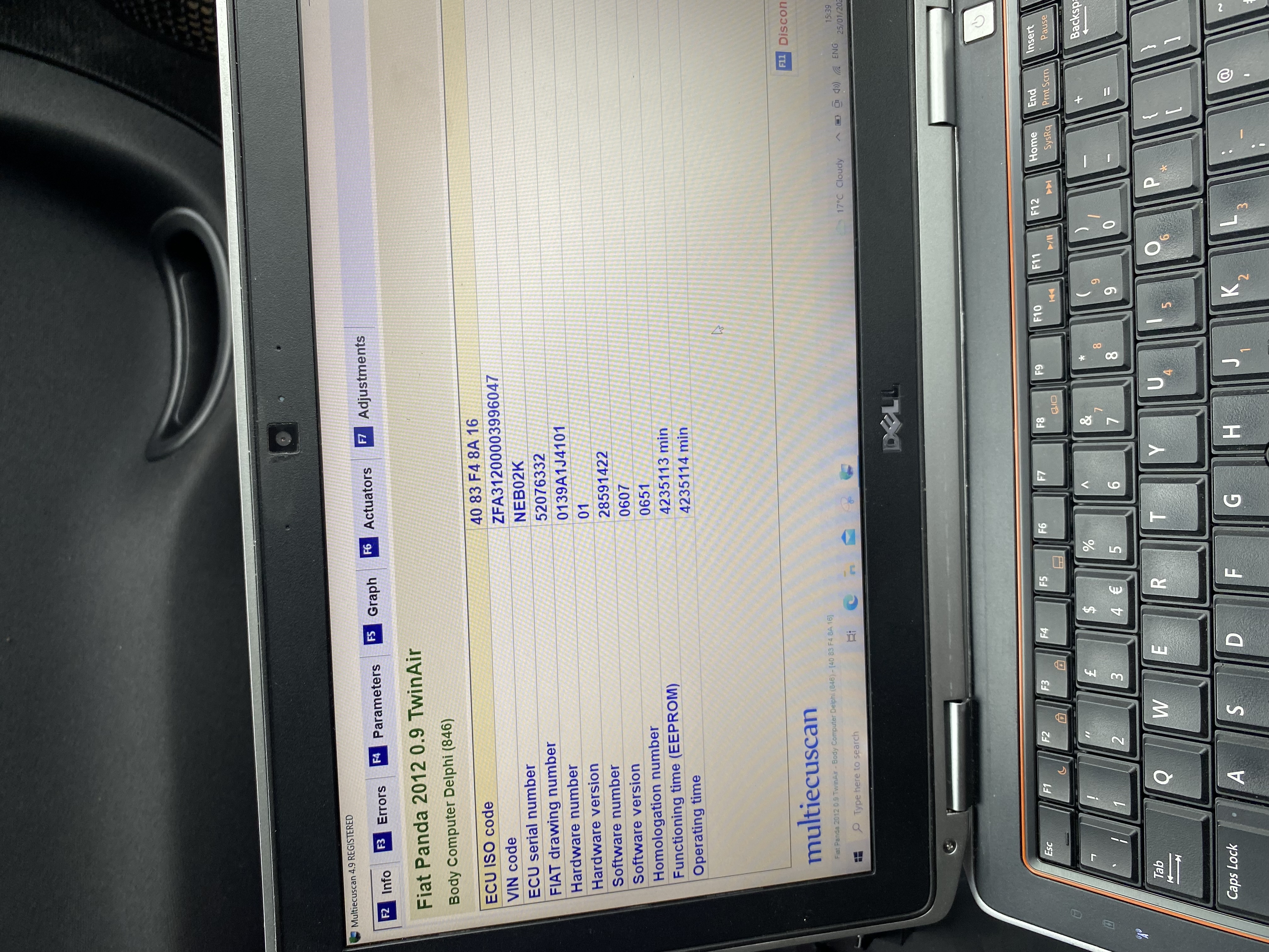

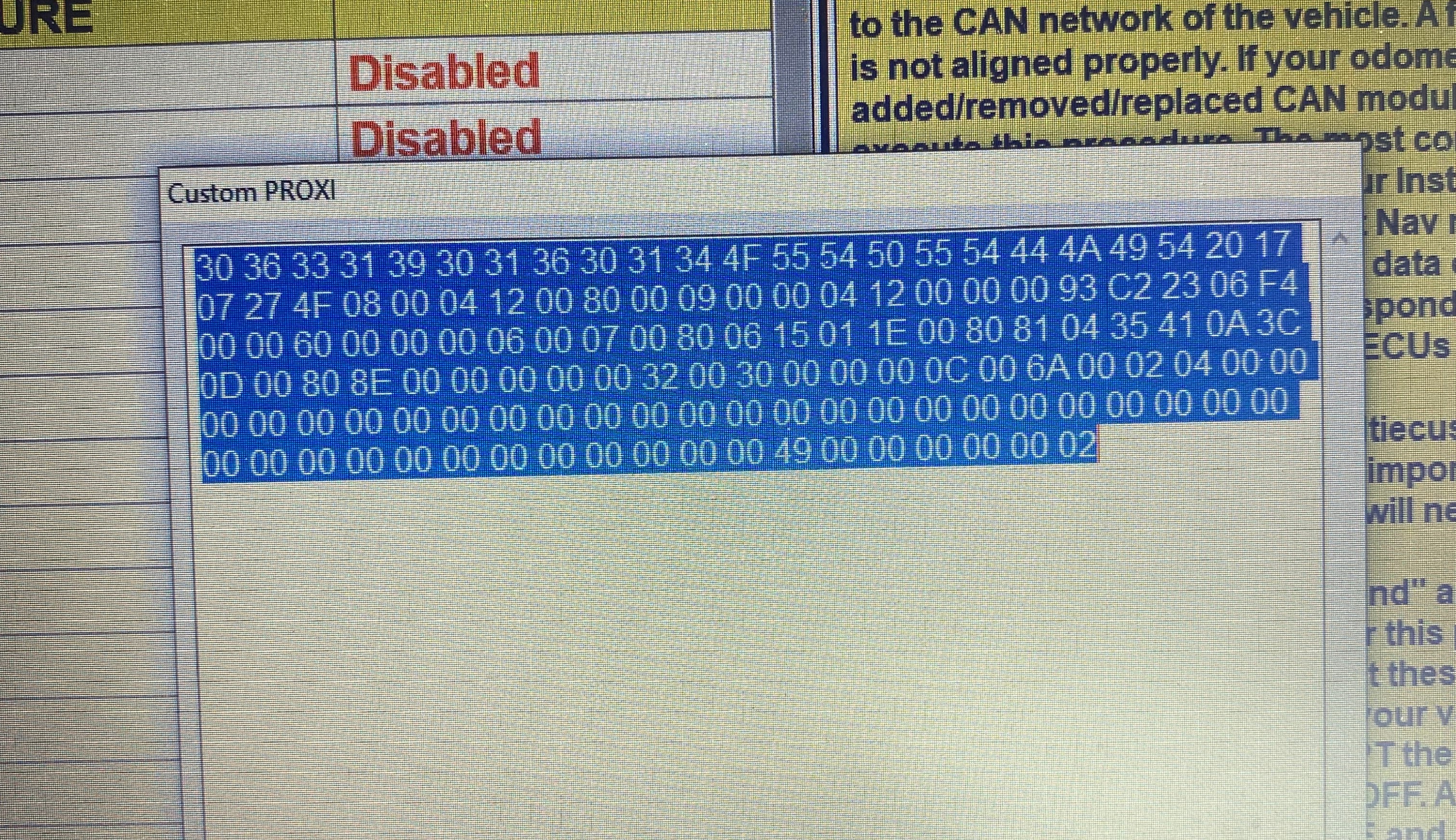

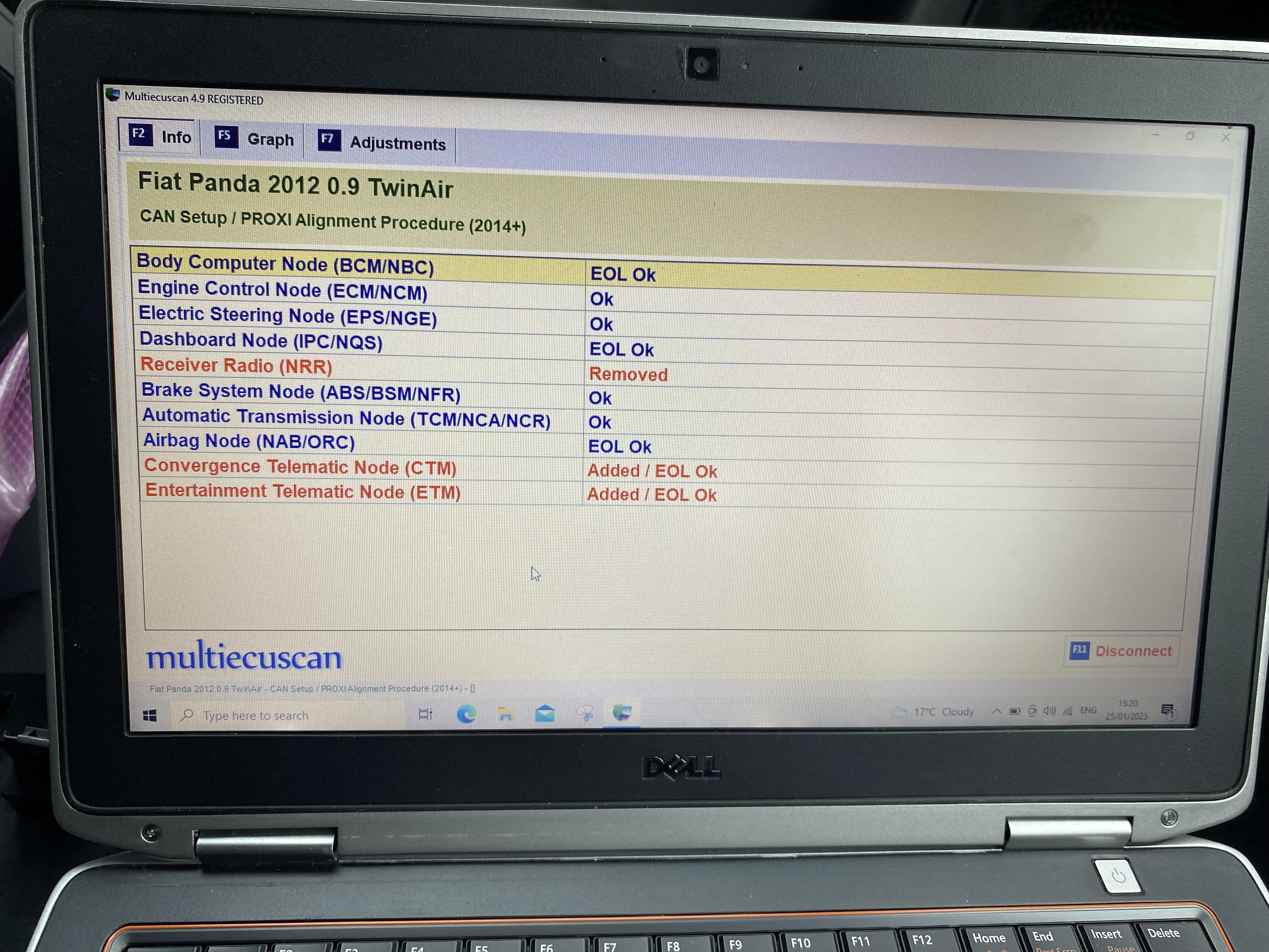

I attempted to Proxi align a Fiat 500 2018 after an aftermarket radio was installed.
The radio was successfully removed from the installation list and I no longer have the code for it.
My problem is that the CTM was added during the proxi alignment and I didn't realise.
This car does not have the CTM module fitted, it is not under the seat and I did not have the communication code for the CTM before the
Proxi alignment,
I have attached pictures and the custom proxi.
Can you advise what Bytes I need to alter to delete the CTM from the Proxi manually?

why do you have selected "Fiat Panda" and not 500 ?
