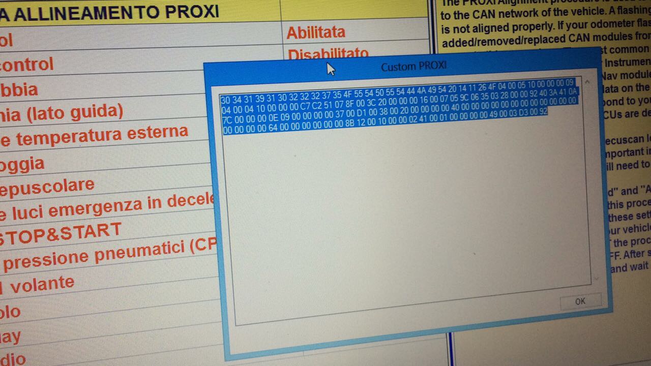

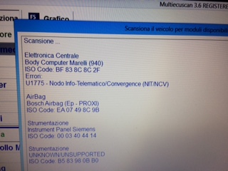

Following a switch from uconnect 5 '' to a uconnect 6.5 '' live I encountered this problem
Finished the physical installation of uconnet live 6.5 i had flashing kms fixed with the alignment
I connected my elm327 and I did the proxy alignment and it happened a strange thing ..
The first is that the parking sensors display (the rear car only) has changed the matrix display now I see the front and rear graphics.
And the other problem is that I have perennially error u1775 node telematic / convergence info (in the central electronics section) I think both blue & me and my car did not see that it is set up with the new uconnet system (my2014)
In the instrumentation section, the new navigation system is unknown / unsupported
I attach photos and ask for clarification

In my opinion, they have not completely changed the proxy, but only partially.

I continue with the discussion ..
After erasing the error 2/3 times it has not been reissued again ..
So the u1775 error is no longer
The real problem is that installing on my friend my 2014 an uconnet live my 2016 navigator and activating the bit suggested by yani in private to another alpha forum user for the precision bit has been brought to 90 i changed the graphics Parking sensors ... now I have front and rear while as standard I only have the rear ..
I wanted to know if there is another bit or change the value to still have the live button and the correct graphics
I attach my original proxy without modifications .. maybe yani knows how to explain how to change to have the live features
There is another problem with this navigator
I do not see as an option the synchronization of the time with the gps where the series should be there
Here is my proxy without any changes
- mio.JPG (206.67 KiB) Viewed 103404 times

I have the same problem, if it finally worked for you could you publish your final proxy if possible?
Re: Proxy problem after alignment alfa romeo giulietta
Hi share your proxi string because without seeing bytes we are not able to fix your problem.
The best way is load whole FESlog file or copy/paste it here on the board...

30 34 31 39 31 30 31 36 30 39 37 4F 55 54 50 55 54 2D 4A 49 54 20 13 09 18 4F 04 00 05 10 00 00 00 09 04 00 04 10 00 00 00 C7 C7 51 07 8F 00 3C 20 00 00 00 16 00 07 01 9C 06 2B 03 46 00 00 92 40 3A 41 0A 7C 00 00 00 00 09 01 00 00 00 37 01 E1 01 38 00 40 00 00 00 00 40 00 00 00 00 00 00 00 00 00 00 00 00 00 00 00 00 B1 00 00 00 00 00 10 8B 12 00 10 00 00 02 41 00 17 00 00 00 00 00 00 03 F3 00 D3
giulietta 2.0 jtdm 2015
install u connect 6.5 live
PROXY CORRECT?

Alternator D+ Signal Source: From engine
Model Configuration: short EU (5 seats)
Heated Windshield: Not enabled
Hood Ajar Switch: Not enabled
Sunroof: Not enabled
Emergency Stop Signalling: Enabled
Removable Ceiling Light: Not enabled
RadioX-OverPresence: Not enabled
LED 1 - Backlighting: Not enabled
LED 2 - Bluetooth: Not enabled
LED 3 - GSM: Not enabled
Steering Wheel Buttons Type: Type B - 8-Button/10 commands US
LEDs 4 and 5 - Customers Disposal: Not enabled
Microphone Tuning Parameters: 250 'Panorama' Model
Human Machine Interface (HMI) Configuration: No Display Available (Only Vocal HMI)
Audio Output: Audio Output Mono and Analogue TelMute
Audio System Type: Not enabled
Ant Supply Configuration: Not enabled
AUX port: Not enabled
Rear View Camera: Not enabled
External Amplifier: Not enabled
Switch Off Time: Time 1
Radio Display Info: Not enabled
Dead Reckoning Availability: Not enabled
Network Management: Not enabled
Alarm System: Not enabled
Remote Control Key: Enabled
Blinking at Central Door Lock (CDL): Enabled
Dead Lock: Not enabled
Country Code: EEC
Siren Present: Not enabled
Ultrasonic Sensor: Not enabled
Anti-Inclination Sensor: Not enabled
Number Of Doors: 4 Doors
Trunk Door Absent/Present: Enabled
Remote Keyless Entry (RKE) Horn Chirp: Not enabled
Trunk/load Department Independent Opening: Not enabled
Rear Open Window/Flipper Glass: Not enabled
Back Lateral Doors Type: Hinged Doors
Fuel Door Release: Not enabled
Anti-Frost Sensor: Enabled
Anti-Pollution Sensor: Enabled
Anti-Fog Sensor/Humidity: Not enabled
PTC additional heater: Not enabled
Pre Heater: Not enabled
Parking Heater: Not enabled
Max Def Strategy: Logic 1
Head Light Levelling: Enabled
Overspeed Warning: Not enabled
Odometer Units Change: Enabled
Diesel Particulate Filter (DPF) Present: Enabled
Daytime Running Lights (DRL) Menu Enable: Enabled
Auto Close Menu: Not enabled
Oil Information: Not enabled
External Temperature Sensor: Enabled
Front Passenger Disable Switch via Menu: Enabled
Greeting Lights Menu: Enabled
Buzzer Type: Internal
Fuel Tank Type: Type 3-45 litre
Side Marker: Not enabled
Instrument Panel Internal Light Sensor: Enabled
Tachograph: Not enabled
Dimming Menu: Not enabled
Headlamp Levelling: Not enabled
Rear Parking Lights Type: Light Bulb
Additional Tail Light: Not enabled
Emergency Switch: Enabled
Heated Windshield/500L (DRL)/Turn Light Strategy: Not enabled
Remote Control Type: 3 buttons
Heated Seats: Not enabled
Daytime Running Light (DRL)/Turn Light Strategy: Not enabled
Battery Type: 72Ah 600A EN2 Heavy Duty
Tire Pressure Monitor System (TPMS) Type: Premium
Tire Pressure Monitor System (TPMS) Configuration: Logic 1 (NHTSA enable warning)
IAM Unit: Enabled
Advanced Driver Program Type: Not enabled
Fiat 500: ECO calibration variant: Not enabled
Non-Fiat 500: Third Stop Light: Not enabled
Fiat 500: Model equipment: No definido
Non-Fiat 500: Key-In Warning: Not enabled
Non-Fiat 500: Cabin Lights with Dimming: Not enabled
Front Driver Airbag: Present Dual Stage
Front Passenger Airbag: Present Dual Stage
Driver's Curtain Airbag: Enabled
Passenger's Curtain Airbag: Enabled
Driver's Knee Airbag: Not enabled
Passenger's Knee Airbag: Not enabled
Front Side Airbag: Enabled
Rear Side Airbags: Not enabled
Front Passenger Disable Switch: Not enabled
Rear Disable Switch: Not enabled
Front Crash Sensor: One Sensor
Lateral Crash Sensor: Set on B Pillar
Front Driver/Left Pretensioner: Present Dual Stage
Front Lateral Passenger/Right Pretensioner: Present Dual Stage
Front Central Passenger Pretensioner: Not enabled
Rear Lateral Passengers Pretensioners: Not enabled
Rear Central Passenger Pretensioner: Not enabled
Driver's Buckle Switch: Enabled
Front Passenger Buckle Switch: Enabled
Rear Lateral Passenger Buckle Switches: Enabled
Rear Central Passenger Buckle Switch: Enabled
Seat Belt Reminder (SBR) Unit: Enabled
Front Central Buckle Switch: Not enabled
Front Lateral Passenger Presence Detection: Not enabled
Front Central Passenger Presence Detection: Not enabled
Front Passenger Presence Detection Type: Weight Sensor
Rear Passenger Presence Detection: Not enabled
Rear Passenger Presence Detection Type: Weight Sensor
Lateral Pressure Sensor: Not enabled
ot enablInstrument panel PAD Lamp: Not enabled
Driver Seat Track Position: Not enabled
Passenger Seat Track Position: Not enabled
PAD Lamp Management: Internal in IPC
Starter Type: Type 0
Convergence Configuration: Giulietta UConnect 6.5 Live
Navigation TMC Pro: Enabled
Rear Blower Regulator: Not enabled
After-wipe Disable: Not enabled
Defogger: Not enabled
DRL Type: LEDs
Front Turn Signal Type: 21W
Combined Rear Lighting: Not enabled
Auto-up Inhibition: Not enabled
Rear Blower Management: TYPE 0 (Low Roof)
Gear Box Type Variant (500L only): No definido
Gear Box Type Variant (non-500L): C635 DDCT
Electronic Brake System Type Variant: ESC + Hill Holder + ASR
Brake Type Variant: Type 2 (Caliper/Caliper)
Drivers Side: Left side
Gear Box Wheel Paddles: Not enabled
Carshape: Not enabled
Number Of Doors: Enabled
Car Shape Configuration: Sedan
Fiat 500 only: Engine Type Variant: No definido
Fiat 500L only: Engine Type Variant: No definido
Cruise Control Present: Enabled
Speed Limiter Present: Not enabled
Water In Fuel Sensor: Not enabled
Semi-automatic Parking Module (SPM): Not enabled
All Wheel Drive (AWD) Selector: Not enabled
Drive Style Selector: Enabled
Brand Configuration: Alfa Romeo
Traction Type Variant: Type 1
Wheel Base: Not enabled
Market: Not Tropic
BCM Status Proxi: Not Programmed
Indirect Tire Pressure Monitor System (iTPMS): Not enabled
CMM Present: Not enabled
Driving steering torque (DST) Present: Not enabled
Suspension Configuration (Fiat 500): Sport
Blow-by Heater: Not enabled
Fuel Heater Present: Not enabled
DPF Regeneration On Demand: Enabled
SCR Presence: Not enabled
Vehicle Line Configuration: Not enabled
Brakes Type: Not enabled
Fiat 500: 3-Mode ESC: Not enabled
Fiat 500: Start Stop Presence: Enabled
Fiat 500: Indirect TPMS: Enabled
Fiat 500: External Temperature Sensor: Not enabled
AHB Feature: Not enabled
LDW Feature: Not enabled
LDW Haptic Feedback: Not enabled
TSR Feature: Not enabled
Retarder Configuration: Not enabled
Cold Start: Not enabled
Remote start: Not enabled
Tip Start: Not enabled
Twilight Sensor: Not enabled
Rear Sun Shade: Not enabled
Flipper glass: Not enabled
Fiat 500: Greeting Lights Menu: Not enabled
Fiat 500: Over Speed Warning: Not enabled
Fiat 500: Odo Units Change: Not enabled
Fiat 500: DPF Presencee: Not enabled
Fiat 500: DRL Menu Enable: Not enabled
Fiat 500: Auto Close Menu: Not enabled
Fiat 500: Oil Information: Not enabled
Fiat 500: External Temperature Sensor: Enabled
Ecologic Level: Euro 5
Audio Repetition: Not enabled
Voice Recognition Activation: 1 button
RKE: Not enabled
Hill Start Menu Presence: Not enabled
Speed Repetition Menu: Not enabled
Cluster Display Type: High display
SRT (Street&Racing Technology): Not enabled
Compass: Not enabled
Digital Clock: Not enabled
Temperature Display: Not enabled
Power Inverter: Not enabled
Audio System Type: Base
SDARS Travel Link: Not enabled
Power Door Locks: Not enabled
Disable CD Eject: Not enabled
Browsing Enable: Not enabled
Surround: Not enabled
DAB Disable: Enabled
Phase Diversity: Not enabled
Main Ant Supply Configuration: Not enabled
Acoustic Configuration: Giulietta UConnect 5
External Port Type: AUX + USB
Wi-Fi Configuration: Not enabled
Microphone Parameter: Mic Tuning Set 1
Switch-off Time: 20 min
TMC Pro: Not enabled
RRM Steering Wheel Switches Type: Type A (10 commands EU)/Standard 6 buttons
Microphone Configuration: 1 microphone
Microphone Type: Peiker 300mv
Climat Zones: 2 zones
PAM Configuration: Rear
IR Remote Control Configuration: Enabled
APPS: Enabled
Blinking At CDL: Not enabled
Horn Chirp Enables: Not enabled
Horn Chirp Menu: Not enabled
Fiat 500: Key In Warning: Not enabled
Auto Decklid Release: Not enabled
Additional Languages: Brasilian
Compass Display: present on VP
Navigation Presence: Not enabled
Speaker Configuration: Front Tweeter and Midwoofer and Rear Full Range
Fiat 500: Rear View Camera: Not enabled
Exterior Mirror Turn Signals: Not enabled
Exterior Mirror Courtesy Lamps: Not enabled
FOB Safe: Not enabled
Memory System: Not enabled
Power Folding Mirror: Not enabled
UGDO: Not enabled
Fleet: Not enabled
Ambient Dimmer Switch: Not enabled
AM/FM1 Antenna Type: Active
FM2 Radio: Not enabled
DAB Radio: Not enabled
SDARS Radio: Not enabled
GPS Module: Enabled
Cellular Module: Not enabled
Navigation Info Repetition: Not enabled
Phone Info Repetition: Not enabled
Front Passenger Seat Bin: Not enabled
Front Bench Seat: Not enabled
Heated Steering Wheel: Not enabled
Tow Hooks: Not enabled
Sky Slider: Not enabled
After Wipe: Not enabled
WCPM: Not enabled
Head Lamp Driver Type: No PWM
Compass Mounting Orientation: Right Side Up
Brand Configuration 2: Alfa Romeo
Off Road Pages: Not enabled
Turbo Pressure Display: Not enabled
Turbo Pressure Visualization: Enabled
Target Gear Visualization: Not enabled
Navigation Repetition Menu: Not enabled
Phone Repetition Menu: Not enabled
Audio Repetition Menu
DRL Type: LEDs
Market: Not Tropic
RKE: Not enabled
APPS: Enabled
UGDO: Not enabled
Fleet: Not enabled
GPS Module: Enabled
WCPM: Not enabled
