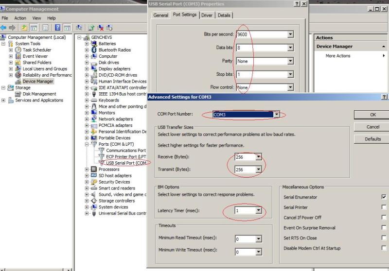

I'm using this version without any problems. There is a new version, but this is good enough i think.
Txt file is exe, just rename it if you want auto install.
Zip file contains driver if you don't want to run unknown executable file on your PC.
Hope that this will help you.
Uninstall all drivers installed before and try this version,
Don't forget to adjust virtual COM port settings, latency ,etc.
Cheers.

Re: 156 W-Reg selespeed, cable ??
This files are driver for USB serial com port.
You need them in order to get you VAG-COM 409.1 cable running properly.
If everything is OK with installation when you plug the cable to USB you should see something like this:
