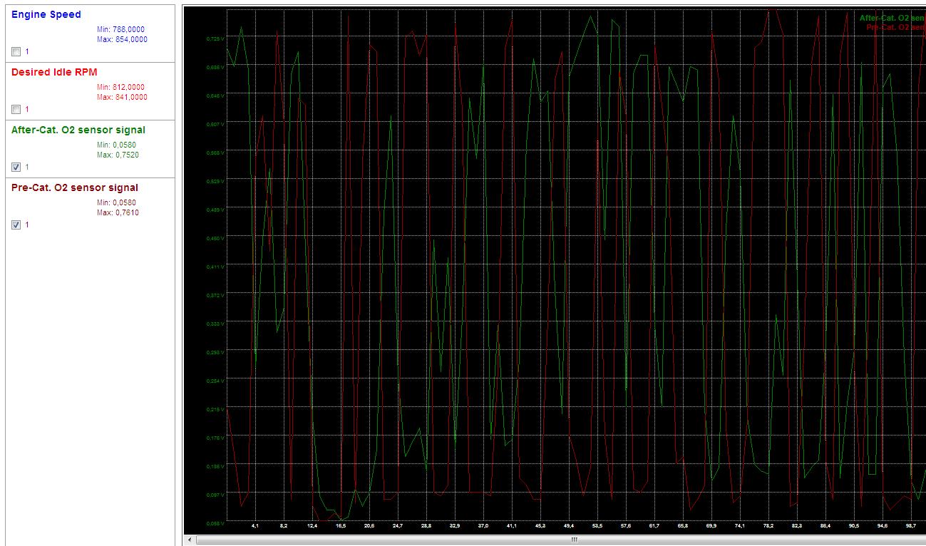

Hi!
Does this graph, and csv file imply, that i have a broken after-cat o2 sensor?
the idle-running rpm is fluctuating all the time, and i dont know, why.
thanks!
O2 sensor signal
O2 sensor signal
- graph1.jpg (192.41 KiB) Viewed 10760 times
FESExp_20100417220547_File2.csv- (8.84 KiB) Downloaded 655 times
Re: O2 sensor signal
What I saw in you CSV its that your fuel mixture work "rich"
It mus have a fluctiation betaween 0.2V (lean) and 0.8V (rich) to be in normal parameters.
That its for pre-cat O2 sensor.
I think that your pre-cat O2 sensor is broken, not after-cat O2 sensor.
The after-cat O2 sensor work well but it show you that your emisions are not in the parameters. It must be near 0.45V and must be pretty constant.
That's because your pre-cat O2 is out of range, working rich.
For your idle can be a cause but not the only one.
My opinion is, that both O2 sensors are ok. Both shows values between 0,05-0,8V and this is ok.
RPM changing on idle is probably due the mess in throttle valve (very common problem).
My picture of o2 sensors: "volnobeh"=idle , "proslapavani plynu"=playing with gas pedal (rpm changing).
http://merkur_sound.sweb.cz//lambdy.jpg

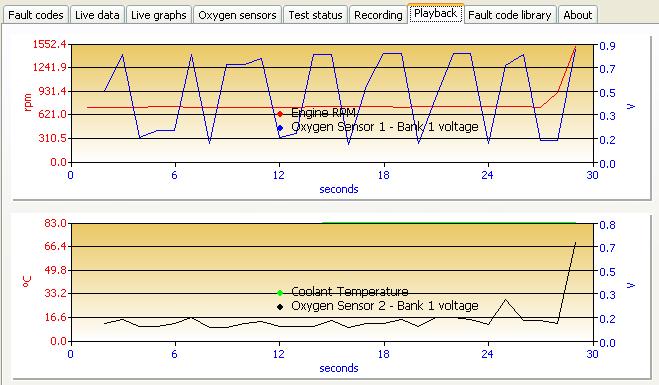

Is there any way you can change the graphical display as it's very difficult to read in the present colours, text size, trace width etc. It's easier to look at the csv data output and that's not the way it should be. The graphs should make it clearer to compare the raw data
Here's a Gendan diagnostics display and it's very easy to see and compare what's happening
- o2 sensors idle rv up and idle sep 2008.JPG (52.48 KiB) Viewed 10509 times

Yes what I mean is the program default settings as people are posting up their graphs in the default settings and they're almost impossible to see
Look at the graph at the top of the page
The more a program works well straight out of the box the more impressive it is
In use in the car then it's usually bright conditions so a dark colour trace on a dark background isn't recommended
