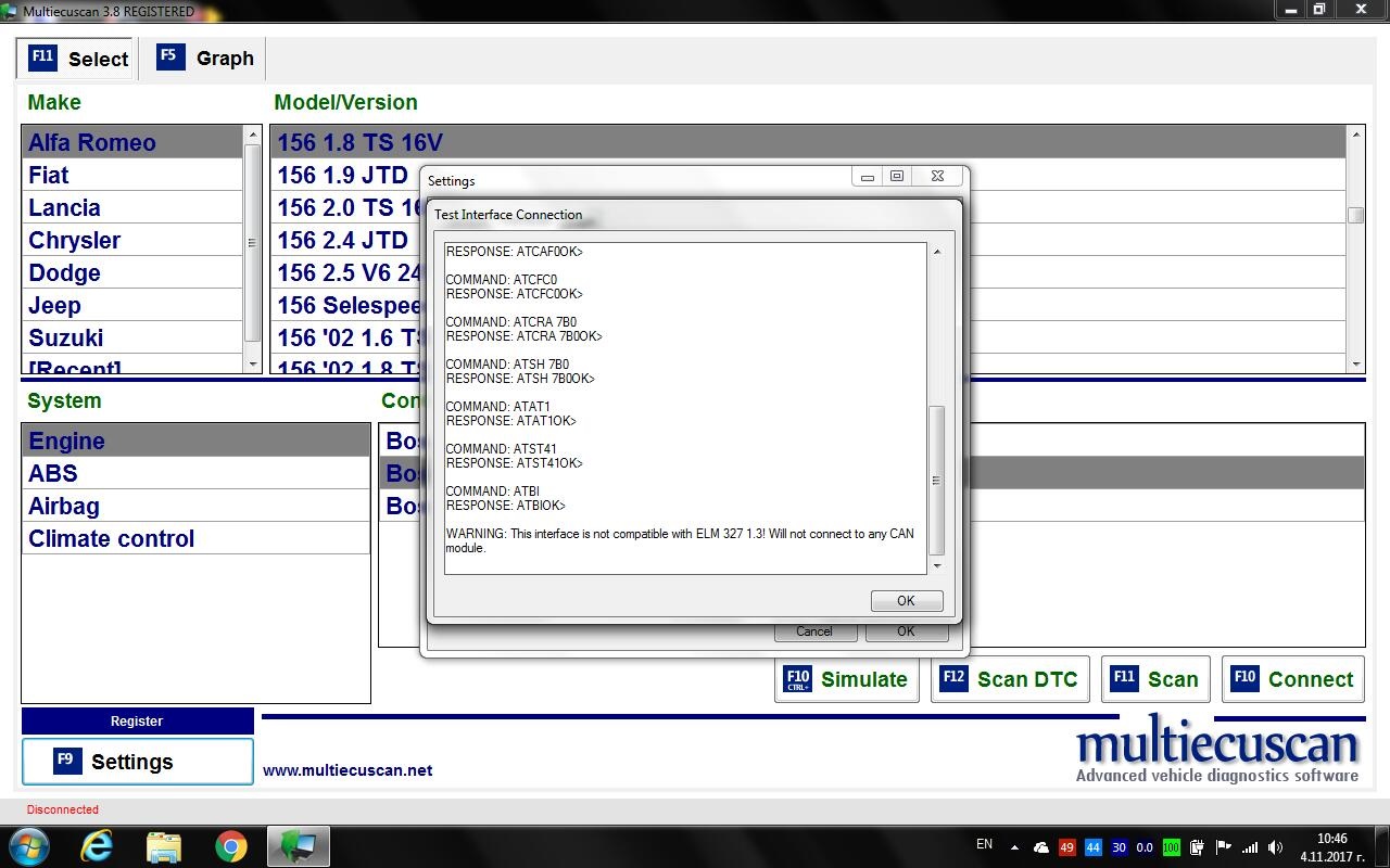

Hello everybody,
I buy from aliexpress one obd2 cable 1.5a but MES show me error to try test
RESPONSE: ATZ
ELM327 v1.5
ELM327 v1.5
RESPONSE: ATL0
RESPONSE: ATH0
RESPONSE: ATSPC
RESPONSE: ATS0
RESPONSE: ATCAF0
RESPONSE: ATCFC0
RESPONSE: ATCRA 7B0
RESPONSE: ATSH 7B0
RESPONSE: ATAT1
RESPONSE: ATST41
RESPONSE: ATBI
have suggestion for resolve this problem?

AlexHF
Joined: 28 Apr 2011, 14:07
Post by AlexHF »
Hi there fans, I have a problem with this Chinese ELM 327 bluetooth adapter. Everywhere the test is ok, but at the end it says it can not connect. Is there a way to go, or I will need another. Thanks!
