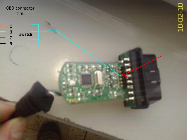

I have differnt type of cable as its on pictures above.
So I should cut the third conection on 6 pin header(instead of first on 4 pin header) and modify as I shown on picture below...?
Is is wright? :shock:

Yes exactly, the third pin from left.

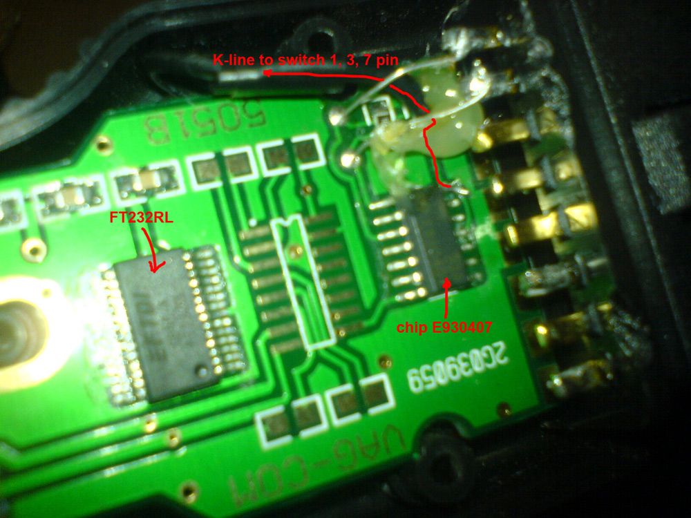

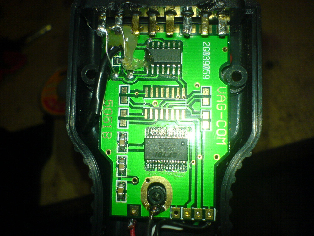

Hi, I mounted switch on my USB KKL VAG 409,1 interface for switching between 1, 3 and 7 pin, but i only read engine codes. When i switch to pin 1 or 3 and choose an airbag or abs and click to connect, the software tries to connect, but several failed. He can not connect to the airbag. My KKL interface is different from yours. I would be grateful if you tell me where else to take the K line, or will ever happen with this interface or must i buy with another scheme and chips.
These are pictures of my interface:
O.E.Motorsport - tuning & innovation
