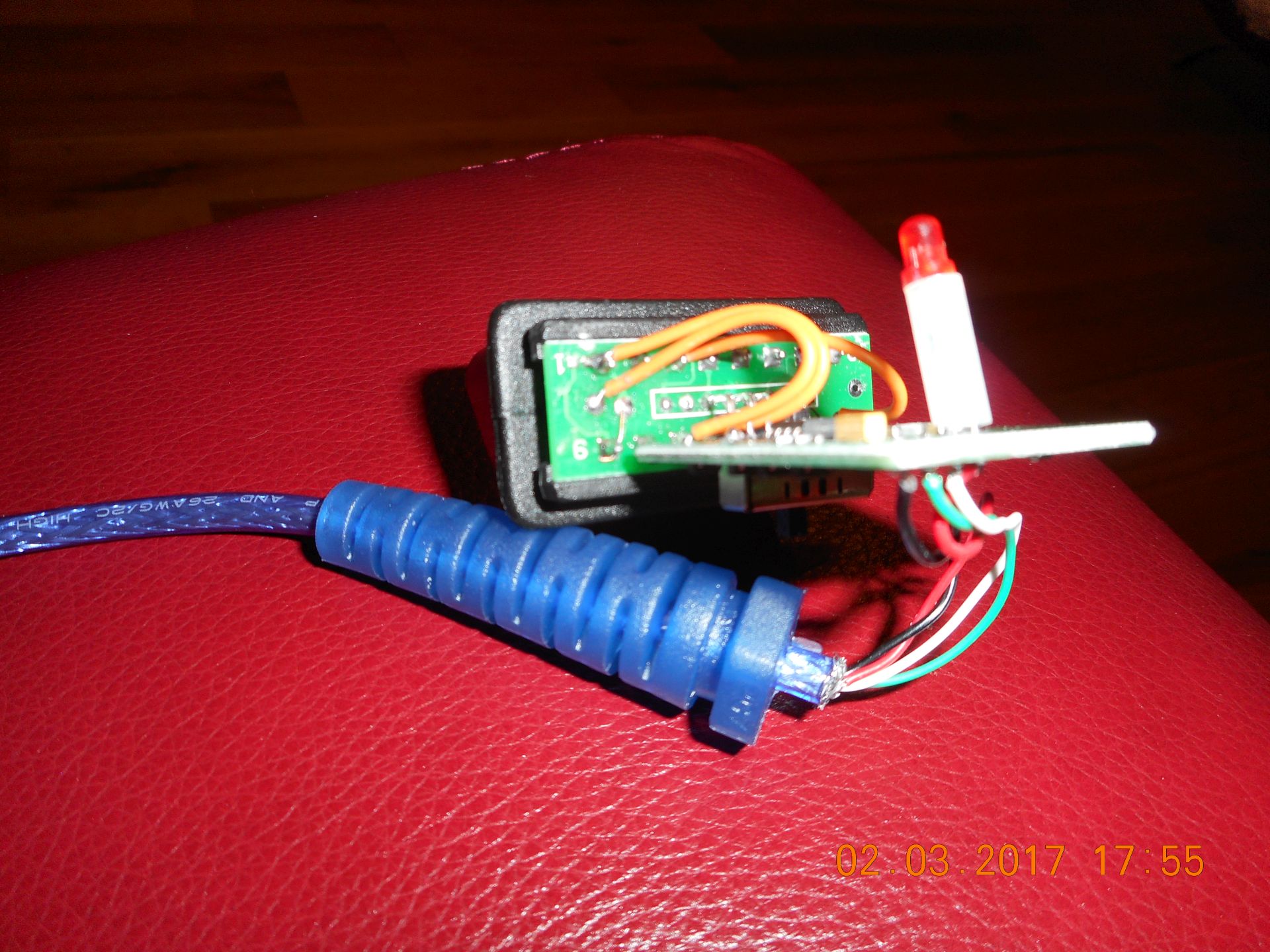

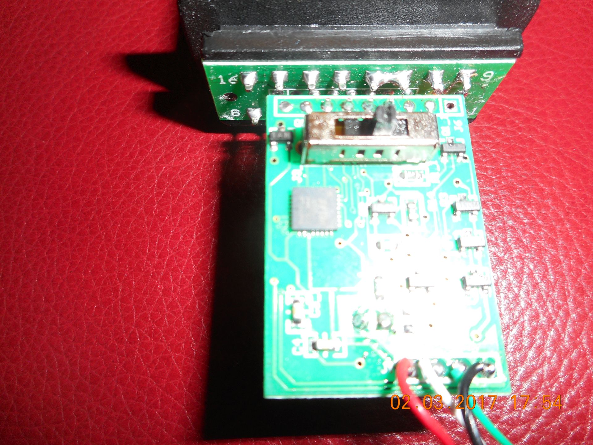

Re: V3.5 on Ducato 2.8JTD, 2005, Bosch ABS 5.3ASR
Looking inside my switched vag kkl lead, I note pins 11 and 12 (not used?) have a solder bridge- is this a problem? Also, it can
be n on the other pic, there is a very thin wire between pin 9 and the central row of contacts , is this normal, or could it be a problem? I assume the cetral row of pins on the pin board are just for mechanical joining abd holding it in position in the plastic housig, or am I wrong, and they form part of the circuits? I can't tell as I can't see the back side of it. Any help still more than welcme. Now I have disabled the software, and am having problems getting the activation back, it seems i will never get this sorted out,lol cheers & beers!
