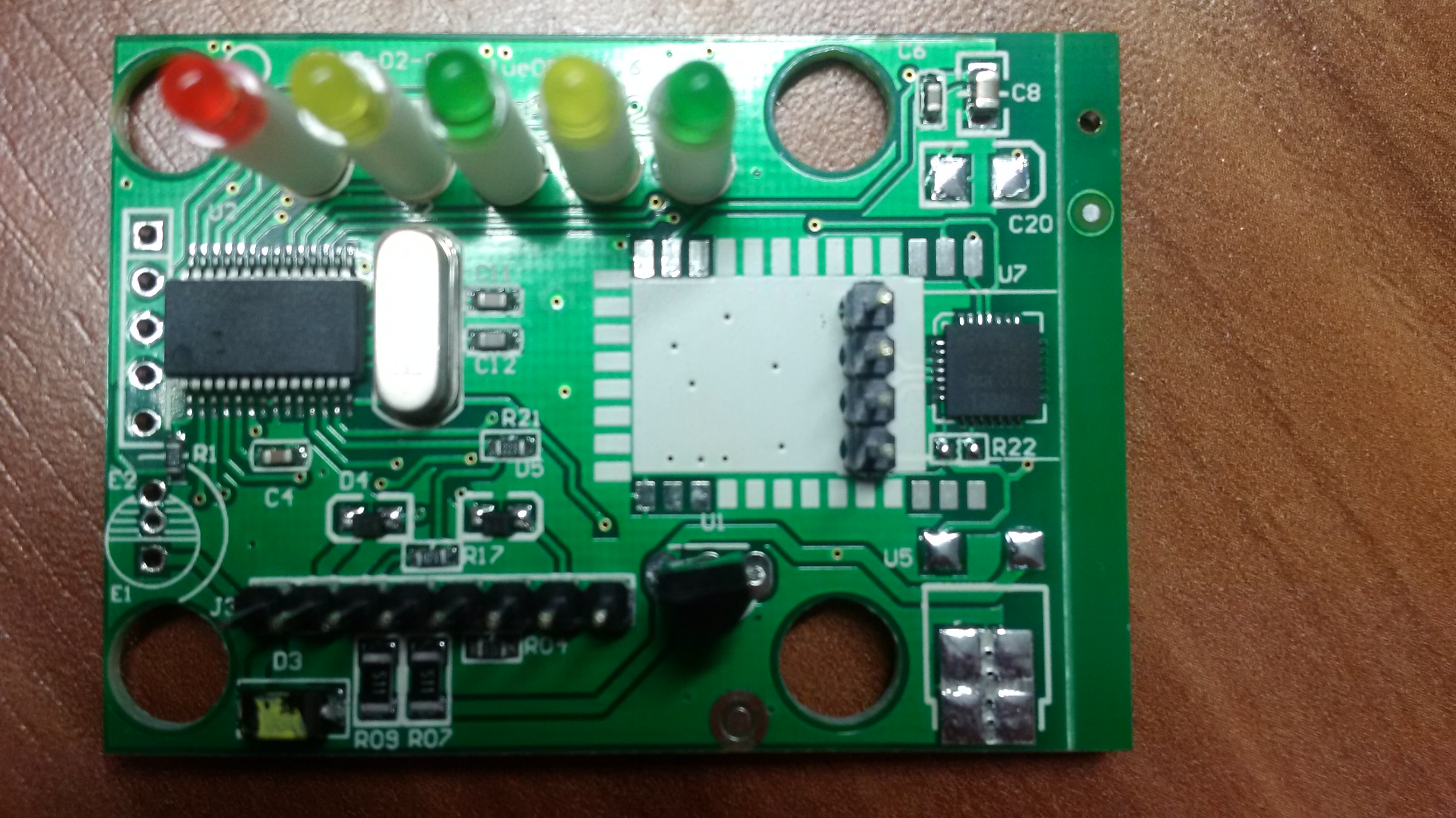

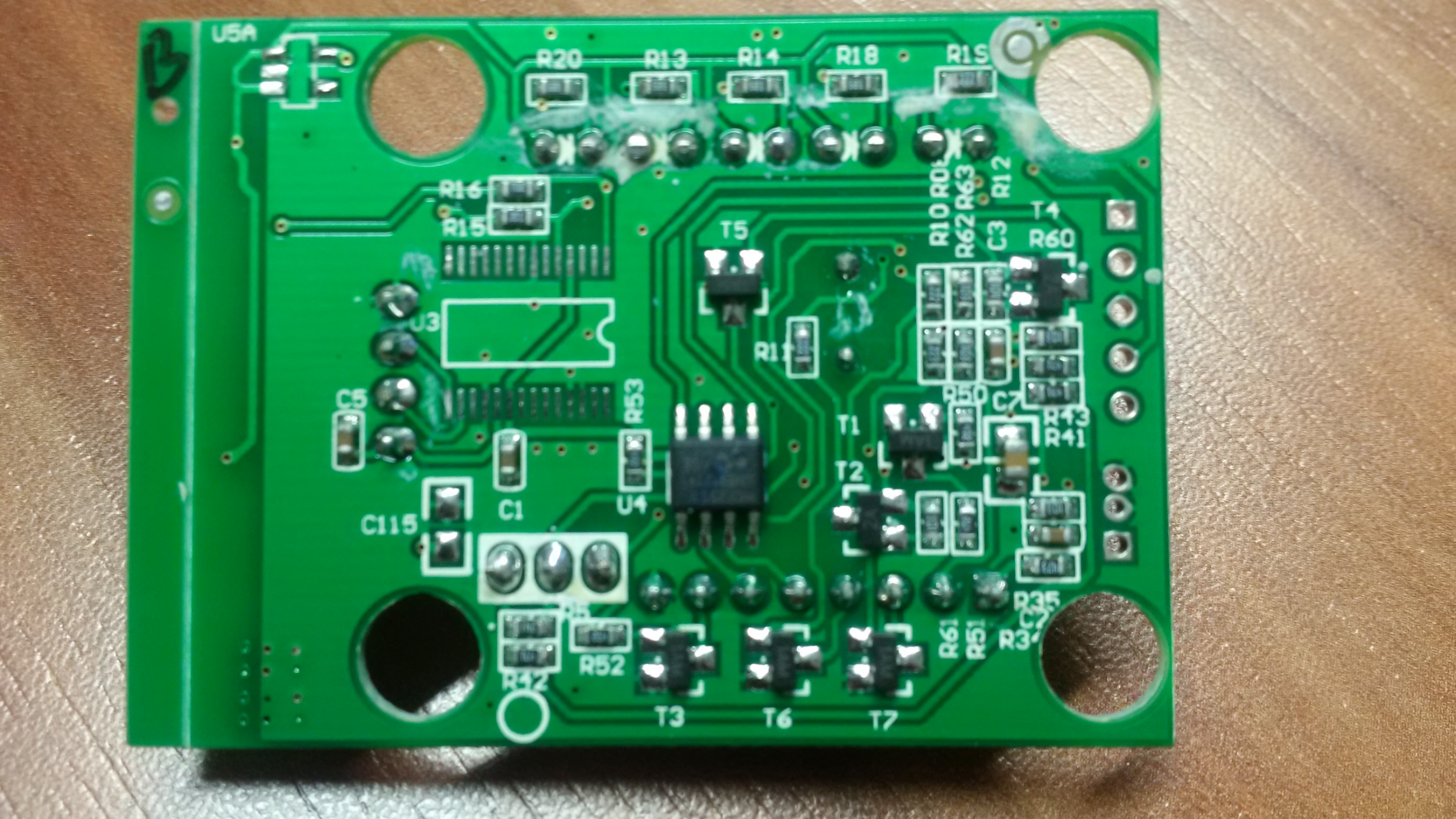

Hi Guys, I need your help and expertise, i bought this ELM327 V1.5a from eBay and it keeps coming up with time out errors, I have opened it up but it does not look like any of yours so please would you tell me which resistor to remove ( my car is a Fiat Bravo 2007 1.4 )
[img]https://postimg.org/image/my1p1onqf/][img]https://s15.postimg.org/my1p1onqf/IMG_4666.jpg[/img]
[img]https://postimg.org/image/4wik3vtpj/][img]https://s15.postimg.org/4wik3vtpj/IMG_4662.jpg[/img]
[img]https://postimg.org/image/96x7zgysn/][img]https://s15.postimg.org/96x7zgysn/IMG_4653.jpg[/img]

Hi I have problem with my ELM, I believe I need to remove some stuff from it. There is 213 pages in this thread but could someone help me which resistors/capacitors I need to remove in order to be able to use low CAN?
diablotic
Posts: 9
Joined: 11 Aug 2011, 19:55
Post by diablotic »
Figured it out - R04 with number 121 on top.
