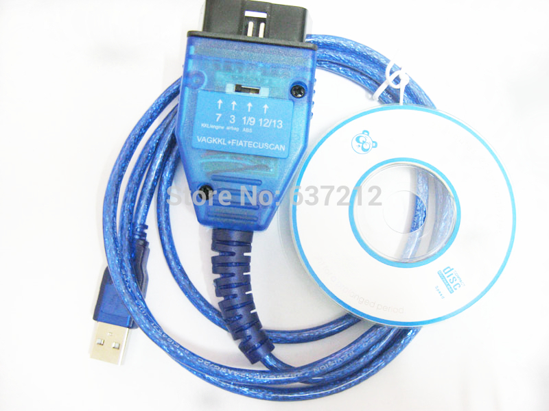

This is the KKL interface I am using.
- kkl.jpg (326.22 KiB) Viewed 13492 times

Do you have the switch in the KKL placed on the no. 3?
Which driver did you use?
which is on the CD not very good and often causes problems
http://www.ftdichip.com/Drivers/VCP.htm (2.10.00 or 2.08.30)
And wiggle times the plug may have no connection pins
Maybe a stupid question?

- Yes, I swith to position 3 when trying to connect to airbag Ecu. Same way with others ECU with their own switch.
- I have used Windows update drivers search. Do you suggest me those in the link? Anyway, I remark that other ECUs are read correctly.

I have tried with another identical interface
. So I do not suppose a interface failure.
I hope you was referring to this.

SOLVED: I've added a connection between pin3 and pin 7; now AIrbag ECU is read, but engine ECU is no more read. I've 2 KKL interfaces...so..that's ok!
