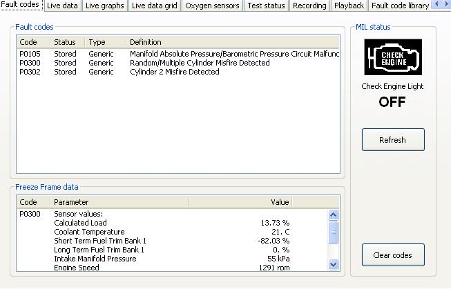

Freeze frame data isnt available on Yani's program yet,maybe it will be some time as the poor man is quite busy trying to get it to work with so may different car types. If you have a ELM conector and a reasonable diagnostics program you can pick up freeze frame data which points to what has been detected and why the fault code is there
Here's a picture
Here's a picture
- fault codes after wet start ok afterwards nov 09.JPG (45.9 KiB) Viewed 5569 times
