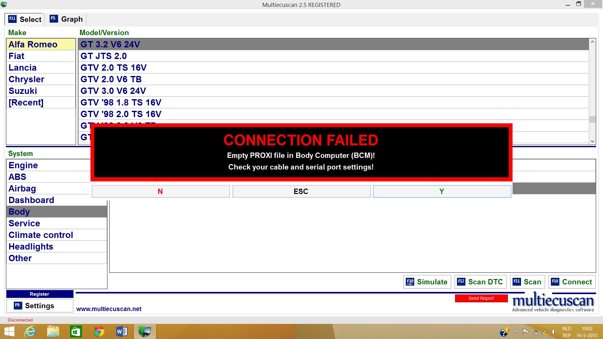

But in the alfa gt 3.2 of my dad (where we have fitted other engine ecu and bcm and key, car starts but odo flashing) when i want to connect, i get the message, "empty proxi file in bcm, please check cable connections"
What could this be? See the attachment How to solve this?
In my other alfa gt 3.2 i can connect to proxi allignment, no problems.

After installing an old fiat ecu scan program (the guy who sold me the bcm and engine ecu + key, told me to do it with that program), i could login but only when the engine was running. not just with ignition on (don't know why).
But if engine was running and connected with proxi allignment, i turned of the engine and immediately ignition back on. After this I did the proxi allignment, all succes except the dashboard node.
Today i tought why not try with the multiecusan again, just ignition on, and yes got connected. At the info screen it says EOL dashboard not, all the rest ok. Did the proxi allignment again, but same error with the dashboard node.
Any idea what this could be? Maybe something badly connected at the bcm, or software errors?
Odo is still flashing.
I also send report with multi ecu scan, don't know if that reaches you yani?
Thanks allready
