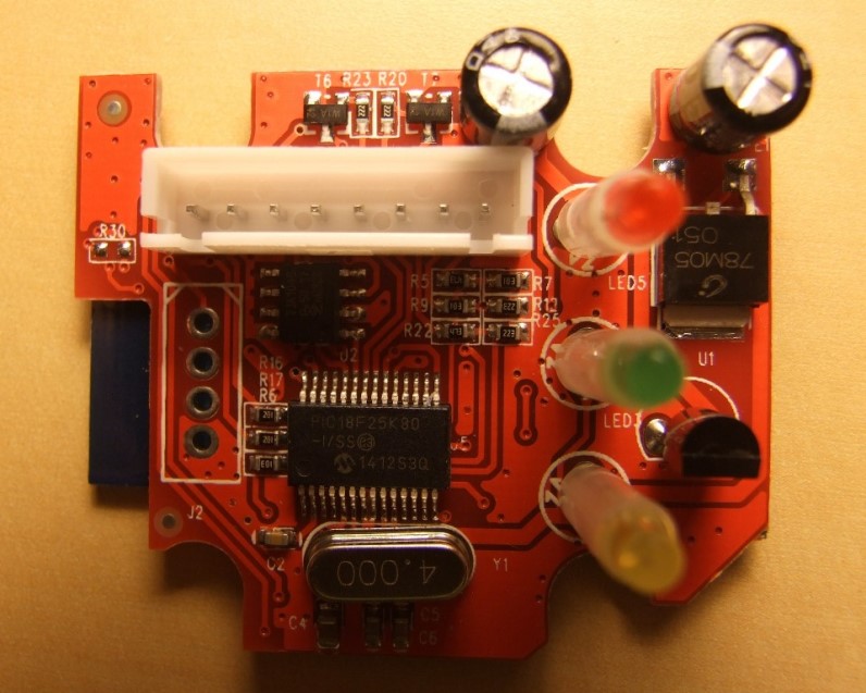

First of all ... thank you very much for your fast response Eddy! You rock !
I managed to open the interface easily after peeling the label.
The front picture:

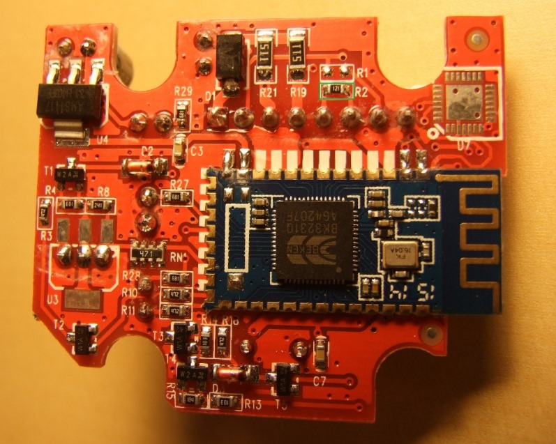

I measured the resistance of little guy with number 121 near the outside pins - it says 118.4 Ohm.
The back pictures were really hard to snap. On the backside are 2 resistors. Both of them say 472.
Controllers say PL2303HX and PIC 18 F25K 80. Transistor says WS LM 317LZ 228Y.
picture is not so good:
I would try to connect to Fiat punto '03 or Alfa 147 JTD '03 or newer. Thanks !
hi Hrconia
Can the motor control and ABS of your Fiat Punto and Alfa 147 you need without changes to the ELM interface read.
To read Body Comp, service, proxy, etc. you have to remove the red resistance.

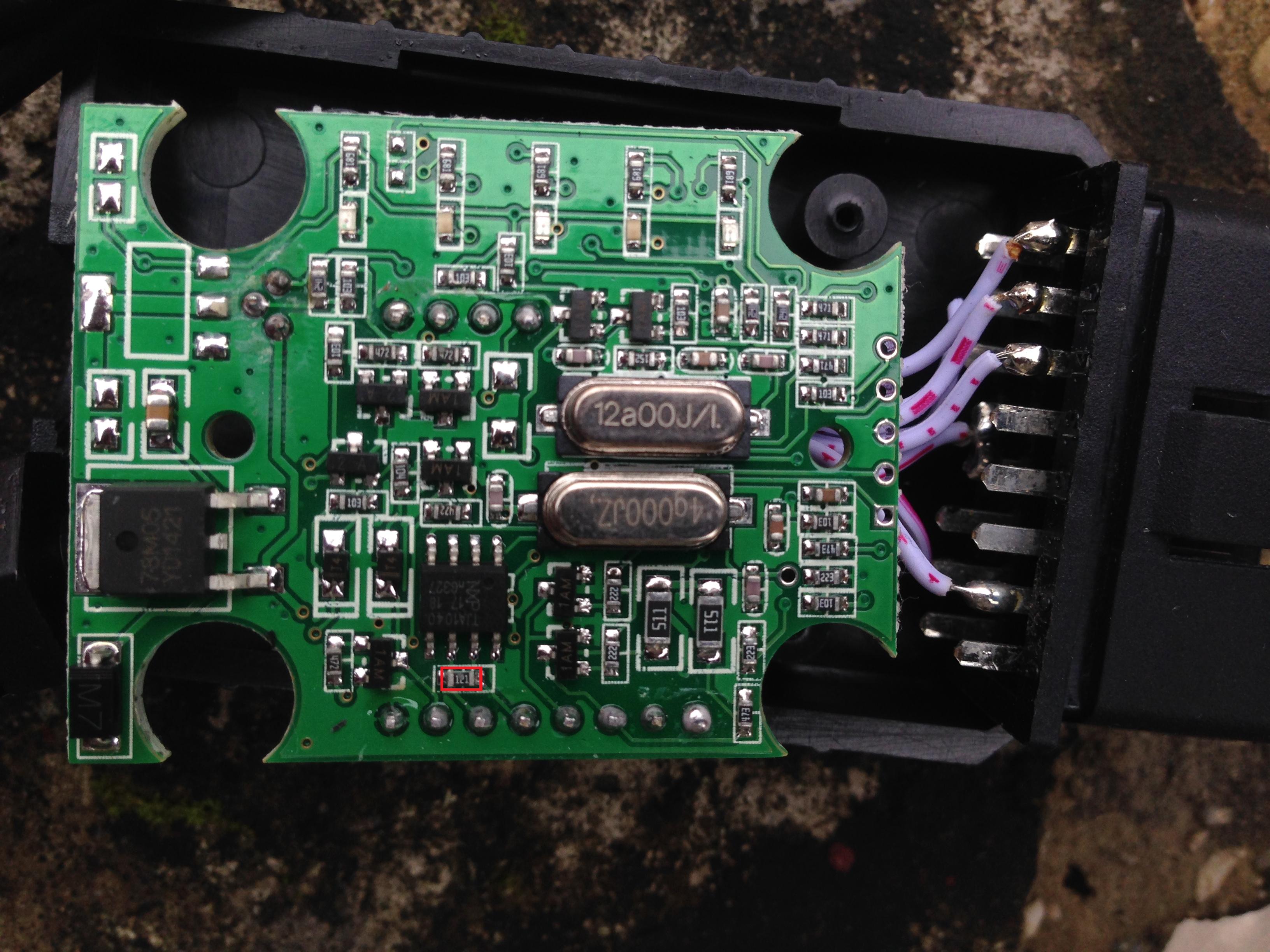

Just found this post trying to figure it out why my ELM scanner bought on ebay was not able to connect.
I need to connect to an AR 147 1.9 JTD 16V in order to reconfigure the alarm key (battery run out and now it is not working with the new one).
After reading some of the posts and seeing some pictures I think I know what to do.
I need to remove the R2 resistor marked as green?
It is connecting pins 6 and 14.

Ja , the Resistor in the green Frame
Gruß Eddy
Gruß Eddy
