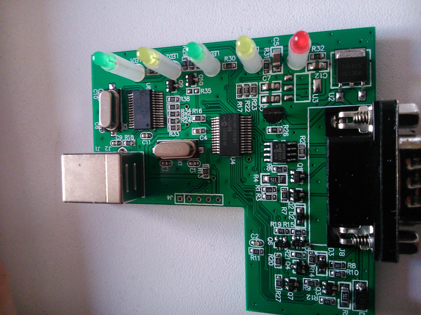

I opened my BT interface, and from what I understand, you have to eliminate the resistance highlighted in red, between the two channels of balanced line of CAN, H and L (I think it is not correct to put this resistance, if we had 10 devices with a resistance of 100 ohm, there is a parallel resistance of 10 100 for a value of only 10 OHM, and it would be too low).
Give me kindly confirm what I wrote;)
Thanks to all
greetings
mark
Hello Mark
Just right
This is the bridge resistor causes the CAN bus problems with MES.
Marco

Thank you,
I removed the resistor, and now I can read the data,
with AlfaOBDDemo, I can read data from Body computer and instrument panel
In addition, the alarm has resumed normal operation.
I still can not run the program "Launch Delta.apk"
thank you very much and Matty Eddy
mark

Can anybody take a look on attached interface and tell me please if I have to do any modification ?
Thank you all in advance
Hello edoixxx
What problem you have?
What controls you can not read?
Because this bridge resistor was just for the CAN bus protocol.
When it comes to the CAN bus, then remove this red marked resistor
DSC_0509 markiert.jpg (308.7 KiB) Viewed 11469 times
edoixxx
Joined: 08 Jun 2014, 15:36
Post by edoixxx »
I am only able to read engine data .
ABS , electric steering , instrument cluster and all other functions give a error to check cable,
That means that I have to remove the marked resistor marked by you ?
Thank you for your quick reply
Hello edoixxxx
What car?
So it looks like yes
Remove the marked resistance and try again
My question therefore is send from your boards the many me pictures
but not all have controls that are read via CAN bus.
