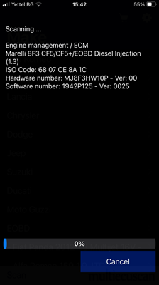

Scan vehicle/modules
Click the "Scan" button on main screen to perform full scan for modules and DTC codes in each module. The app will display the SCAN screen and will start the scanning process. The full scan usually takes a few minutes and the app will display the progress.
When scan is complete, and Multiecuscan has found error codes in one or more modules, it will display "Clear Errors" button. You can tap on this button to clear all error codes from all modules.
