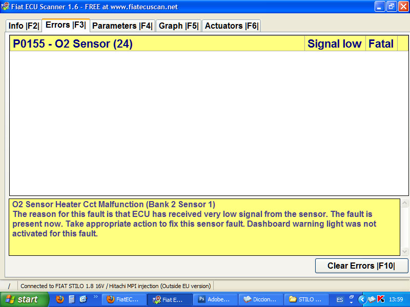

I used multiecuscan today FIRST TIME and found an error . I am attaching a screen with error.
can anyone help me find this sensor?
P0155 -02 Sensor (24)
BANK 2 SENSOR 1

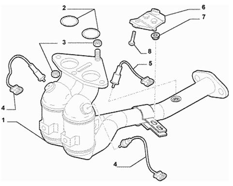

The O2 sensor heater is built into the O2 sensor. It's usually the 2 white wires from the sensor. The sensor is one of the items #4 in this diagam. P0155 refers to bank 2 so it will be the one on the right, looking from the front of the car.
