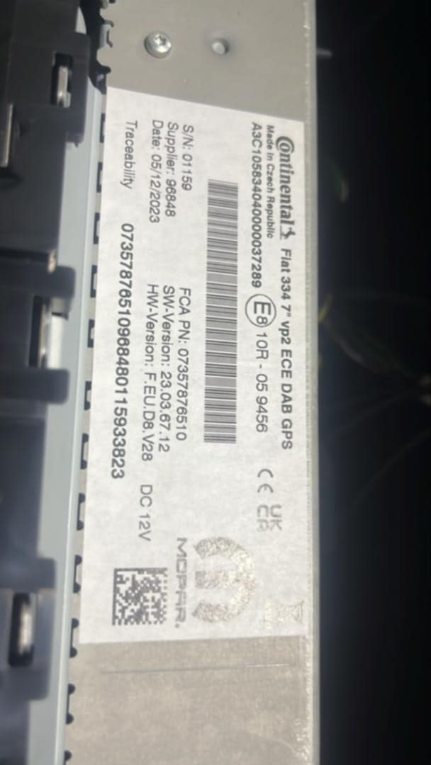

Have you checked the engineering menu as suggested by Chrener? Does the headunit have the RVC HW?
