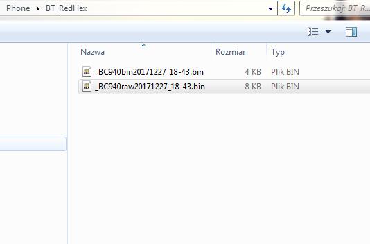

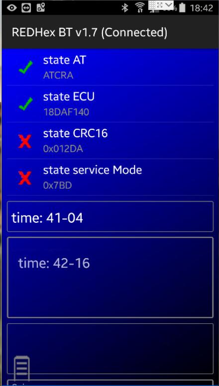

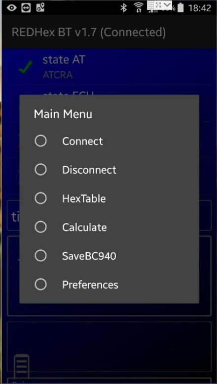

- I wrote applications for android to read a body computer of Mageti Marelli type 10 such as Giulietta.
- The application reads 4 kB through the OBDII connector and OBDlink-Mx Bluetooth interface ELM327.
- Reading time is about 70 seconds, then the results can be saved to a binary file.
- size of the file is 2 MB.
- link to file
