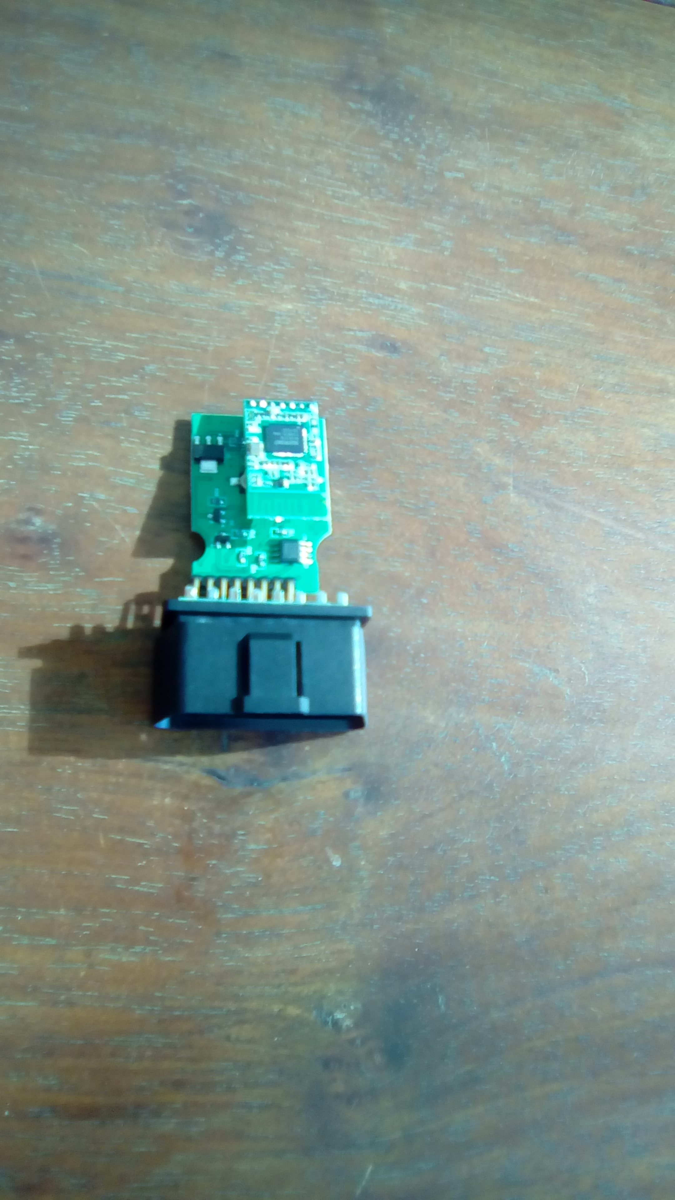

Unmodified wifi ELM 327 is connected to my licence software: EPS and ABS amoung other are readed.
To access the convertible ECU:
- It will be easier for me to connect 1 and 9 without cutting 6 and 14. My ELM has no wiring inside, only hard pins and IC. Any advise ?
- Strange I found 9,1 Ohm between pin 6 and 14 with my multimeter. I dont find any 10 ohm resistor on the board. Only a 120 close to an LM chip. Is my multi meter out of order ?
Sorry for the picture with a cheap phone.
