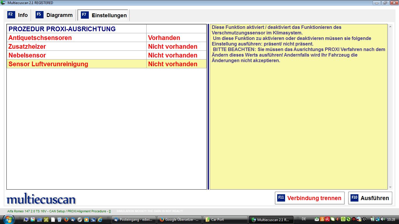

Can you post screenshots of this?
We have not removed the PROXI procedure. It could be some kind of bug.
However, I just opened Multiecuscan 2.1 and checked the body section of 147,159,GT,Mito and some other cars and the "CAN Setup / PROXI Alignment" is there.

Hello Yani
I just realized that I was wrong probably :)
Was probably a little late last night :oops:
I did not notice that the proxy settings have been well re-sorted.
and the general approach now has a blue background and is also at the beginning.
The individual strands are highlighted in red.
Is this correct?
I've probably seen wrong :oops:

Yes, that's correct!
We changed this probably a year ago. The configurable options are in red and the PROXI procedure is in blue on top.
