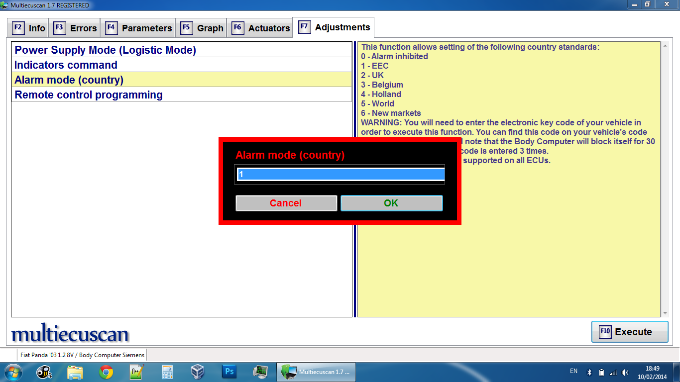

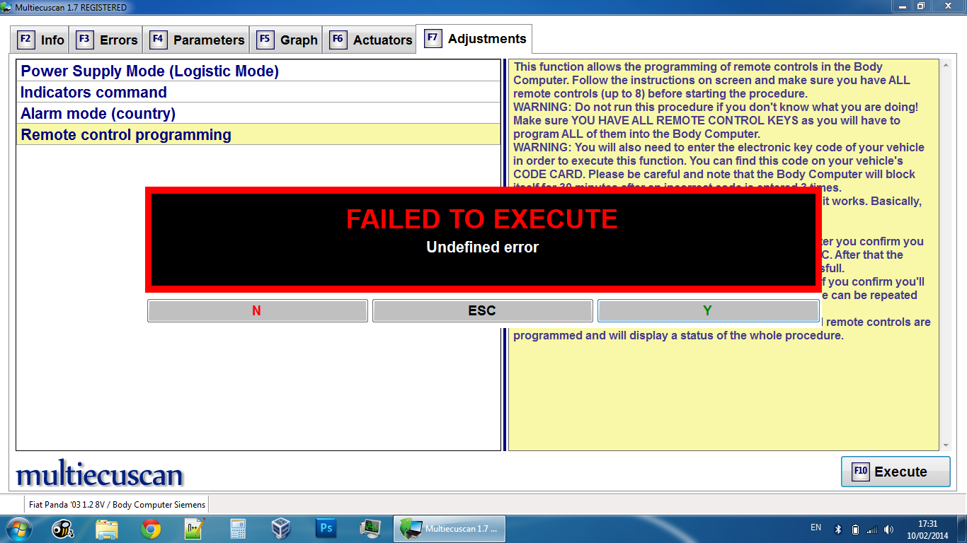

When I try to reprogram my remote key to my 2006 panda body computer I get an error message - "FAILED TO EXECUTE - Undefined error" just after I enter the code from the card.
Also I saw in the parameters list that the unlock button was "Pressed" all the time, even when I removed the remote battery and restarted the pc.
but it changed to "Released" when I disconnected the car battery and reconnected it after 30 minutes. but still can't program the remote key, same error as before.
When I try another function that require the code card it is working ok.
Is it a bug or i'm doing something wrong?

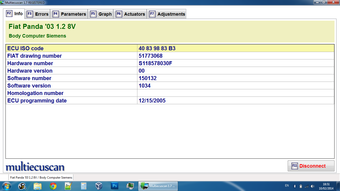

my body computer
my body computer
body computer.png (112.34 KiB) Viewed 9026 times
the error
the error

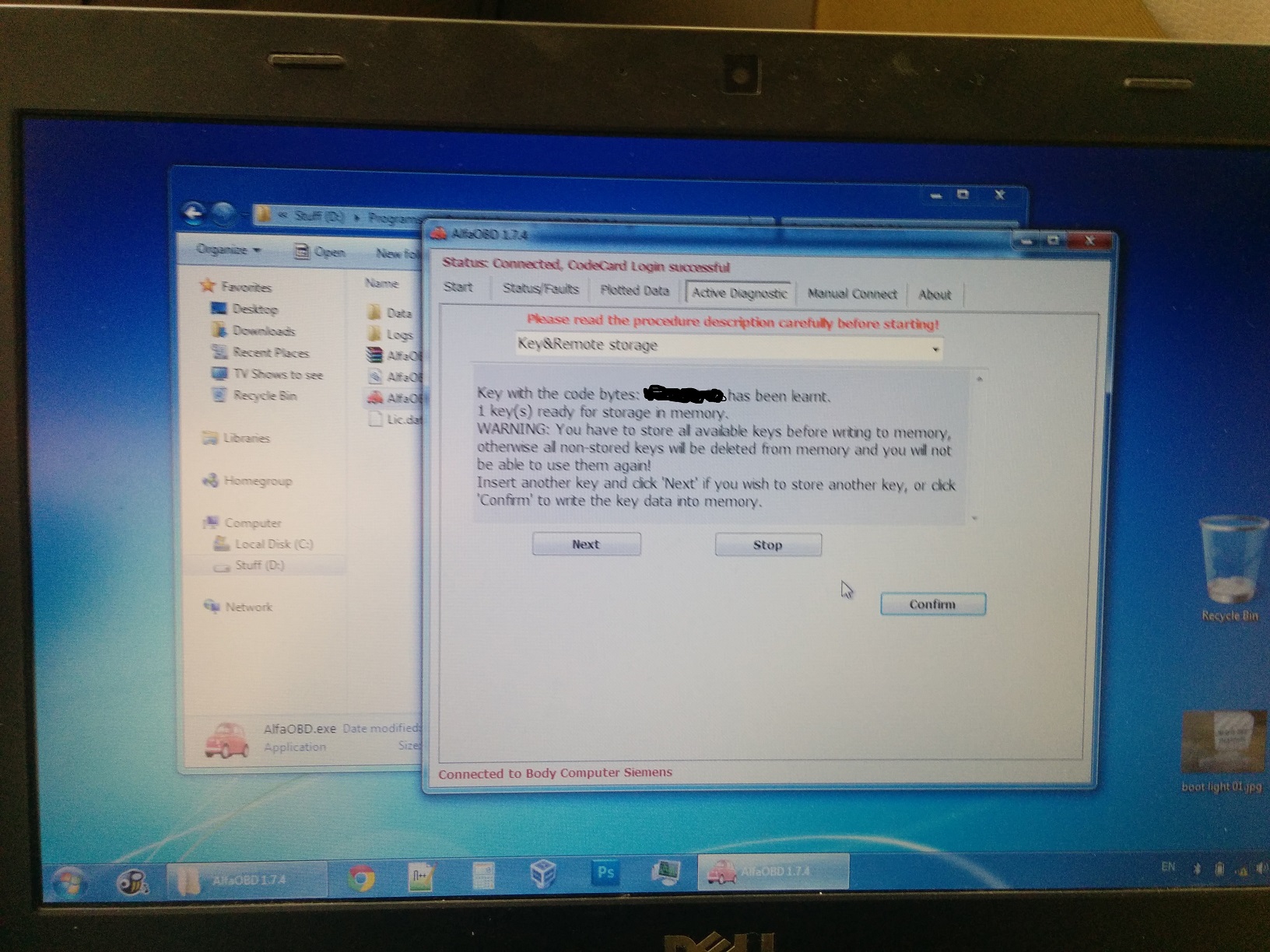

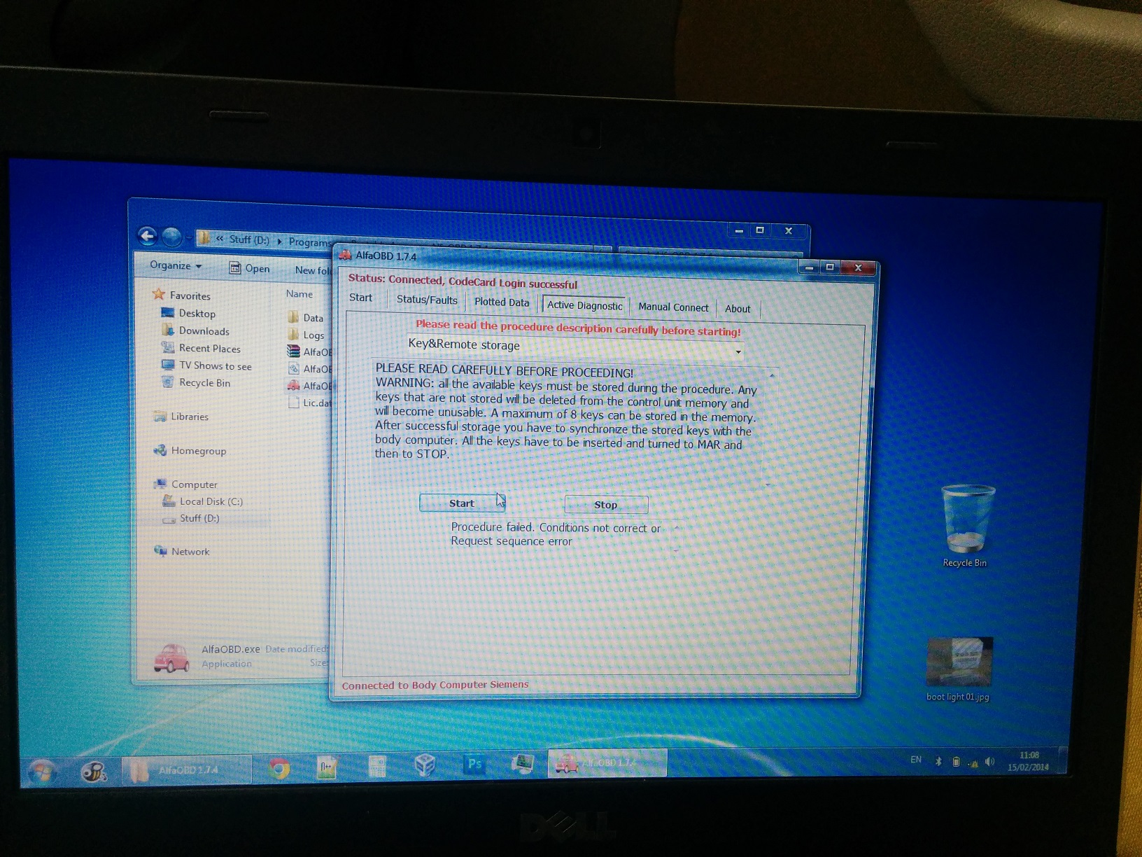

AlfaOBD is also giving me error.. what other software can do this?
I opend a more detaild thread in fiatforum: http://www.fiatforum.com/panda/343540-r ... nized.html

Re: error when trying to program a remote key to body comput
What kind of ELM interface do you have (original/ clone/ other)? :roll:

Maybe you have problems because it is a BT interface...
I prefer always cable interface when I am coding keys, injectors, remote..
