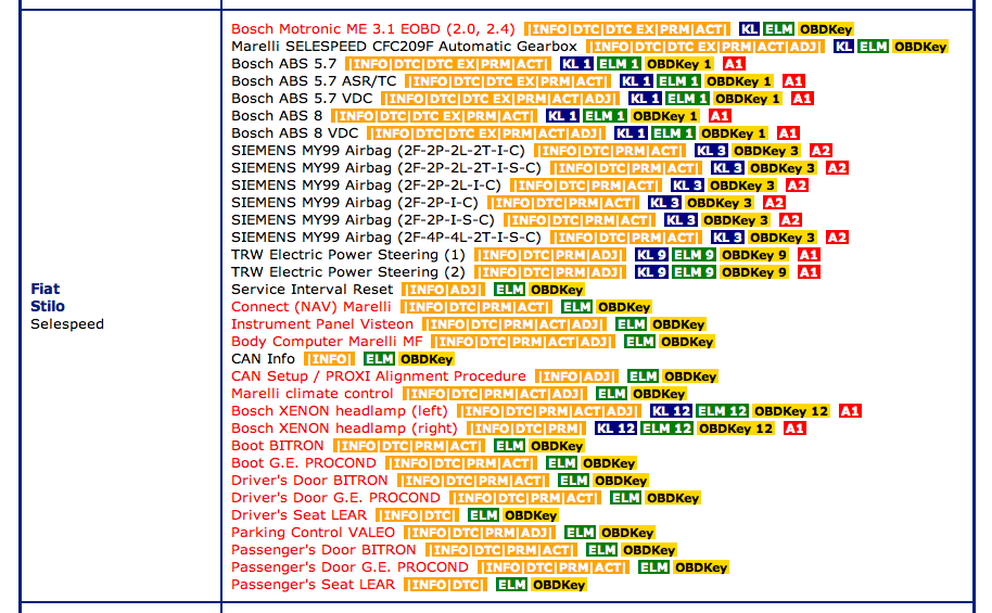

Actually I bought my ELM at a dealer who only deals in diagnostics tools for cars.
From what I can read the resistor modification is only needed if the interface doesn't work at all, but mine connects to both the engine and gearbox.
Shouldn't I be able to connect to the Marelli Climate Control Unit without any adapters?

A dealer for Diagosegeräte, this buy somewhere in China or elsewhere.
And as I have already described several times!
MES interface with these problems only in the CAN Bus Protocol
Therefore, you can also e.g. no connection manufacture of air conditioning.
If a vehicle CAN bus can not be read with these ELM.
Your Selespeed ECU and will not be read via CAN, so this also works
This will read about the protocol ISO14230,
