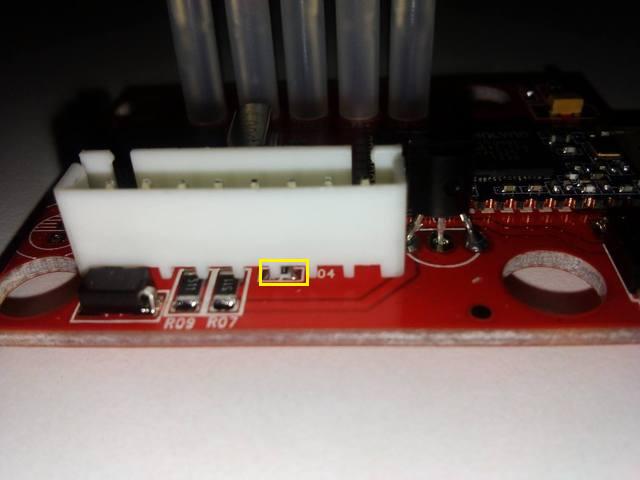

I have a problem ...
without adapters work perfectly, but I can only enter the engine control unit
with the adapters does not enter diagnosis
Re: Problem Elm327 1.5 bluetooth
Posted: 04 Jun 2013, 20:18
Hello cerasaro
What car and what control you want to read?
But according to your description, this is the known CAN bus problem
We have described here several times.
viewtopic.php?f=5&t=1493
Remove the yellow resistance and your interface will work
97746110201163325705899 markiert.jpg (27.54 KiB) Viewed 2323 times

after I removed the resistance will still work on the engine control unit?
I would like to use it a bit with all the cars
I bought the 3 cables adapters
after removing the resistance work?
