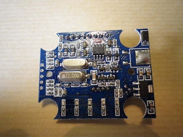

However, I have another worry: I can connect to the motor module, but not the service unit "please check ELM 327 and the configuration of your serial port"
the test function returns me ok all tests.
Panda 1.3 MTJ Marelli 8DF CF5/EOBD
Albert
I'm perhaps not the right section, I do not speak or read English, I apologize.

The problem is that your ELM interface can not read CAN bus
This is a problem of Multiecuscan
Just look at the posts in this thread
viewtopic.php?f=5&t=1493
in the back pages you find solutions for your problem.
Otherwise, an alternate image of your board, and I'll tell you what to do

if I understood, I must destroy my case ELM to change.
I see no screws or opening this device.
http://imagesia.com/imgp1129_88so

There could be screws that hold the two halves of the case together underneath the label.
Run your finger firmly over the label feeling for round depressions.
Failing that then it is probably a 'snap-together' case which will require careful prising apart. You MUST check for screws below the label first though otherwise you will badly damage the case if you try to prise it apart.

There were actually four screws under the label, but the system does not resemble what I've seen on various forums.
http://imagesia.com/imgp1130_89l5
http://imagesia.com/imgp1132_89l6
Albert

Multiecuscan kann mit deinem Interface keinen CAN Bus lesen
ein Widerstand stört diese CAN Signale
entferne den rot markierten Widerstand und dein ELM Interface
ist auch CAN Bus fähig
Gruß Eddy
