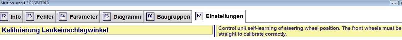

This problem is usually because of a steering wheel position sensor.
Steering angle calibration can help if it is not broken.
