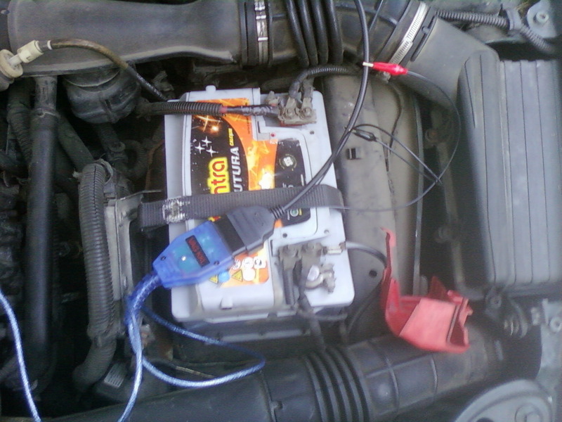

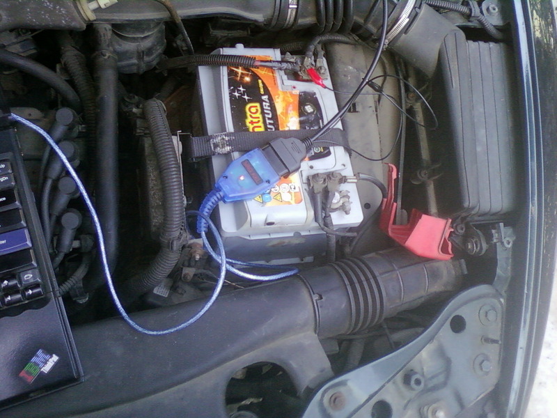

Because it's recomended. I have this adapter: http://www.allegro.pl/show_item.php?item=908733058 but I did not have time to try it(with marea, only tested with stilo EOBD), but from what I read on another forum (in Polish) is just to do so.
EDIT: Well, U forced me to test interfejs and adapter on my marea.
When battery plus not connected, the led light on vag kkl is off and i can't connect.
LED light is OFF
LED light is OFF
When battery plus is connected, the led light on vag kkl is on and i can connect(with airbag, abs and engine-i had to choose brava 1,6).
LED light is ON
LED light is ON
EDIT2:
Correct(with plus connector) adapter U can buy on ebay:
- in PL: http://cgi.ebay.pl/ADAPTER-OBD2-FIAT-3P ... 3a57d33f58
- in D: http://cgi.ebay.pl/Adapter-Stecker-Fiat ... 3ca9b134b1
BAS
