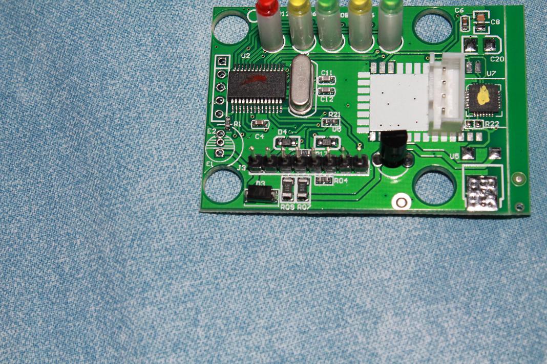

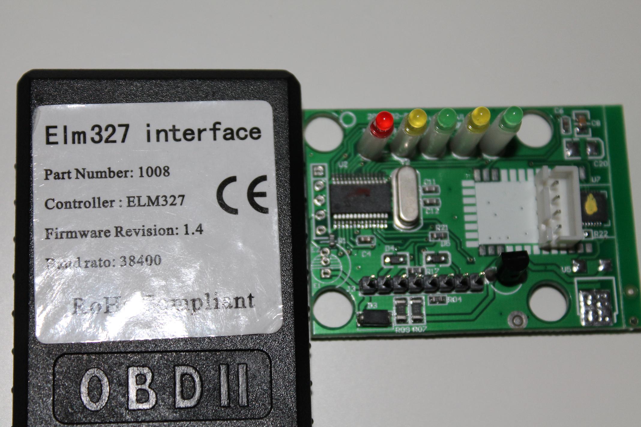

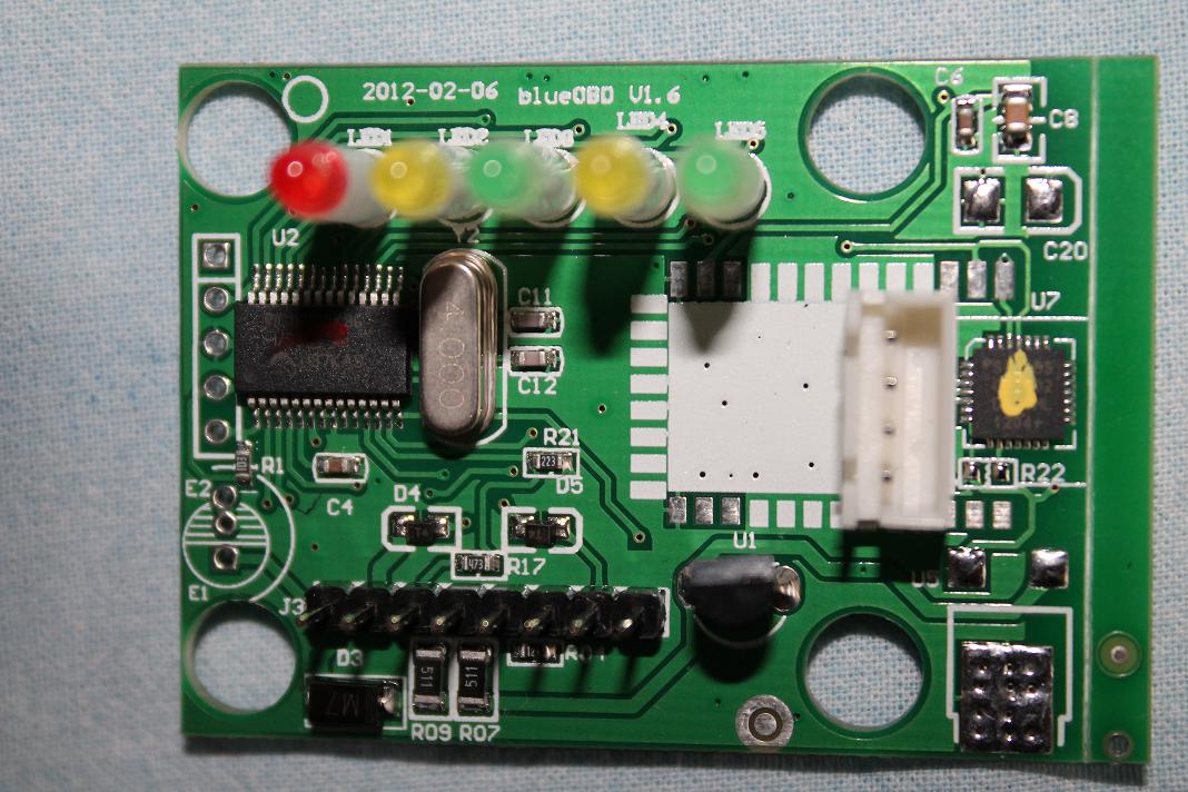

Hello Eddy, I saw the thread but my ELM327 is different from those reported, and still a friend of mine bought the same from the same dealer has the software and a license but had no problema.cosa I could check?
Thanks for your help
Re: help me use multiscan
Hello Giovanni
What control to which vehicle has read your friend then?
Because of Faulty resistance only prevents the CAN Bus Protocol
All other protocols are not affected
