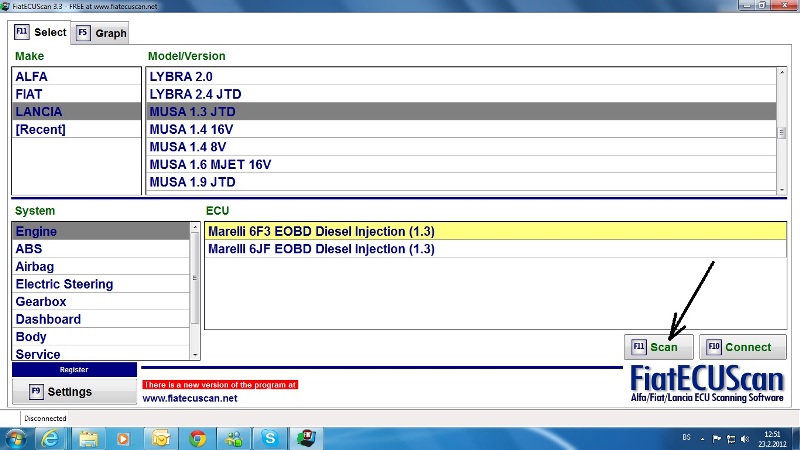

If you are not sure which engine ECU you have
- Marelli 6F3 EOBD Diesel Injection (1.3)
or
- Marelli 6JF EOBD Diesel Injection (1.3)
just press F11 (Scan button) and FES software will tell you what kind of engine ECU you have...
or you can find other Fiat car models who have 1.3mjet engine and try to coznect with that.
you can not lose nothing...
See photo...

Re: Lancia Musa 1.3 mjet 16v 95cv
I tried it, the response was:
Scansione ...
Controllo Motore
UNKNOWN/UNSUPPORTED
ISO Code: 68 07 3B 08 07
AirBag
TRW MY03 Airbag (2F-2P-2T-I)
ISO Code: EA 07 9B 86 67
Elettronica Centrale
Marelli Body Computer (3)
ISO Code: 40 83 45 08 E5
Strumentazione
Marelli Instrument Panel (Comfort)
ISO Code: 32 83 16 83 23
COMPLETATO
Ok, so your engine ECU is Marelli 8DF CF5. Unfortunately, it is not supported in Multiecuscan yet.
This support is for Fiat 500, Grande Punto and Mito.
Unfortunately, the control unit in Musa is a little different and it is not supported yet. You have to check http://www.multiecuscan.net/SupportedVehiclesList.aspx for details about each car make/model/version
