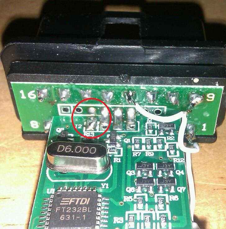

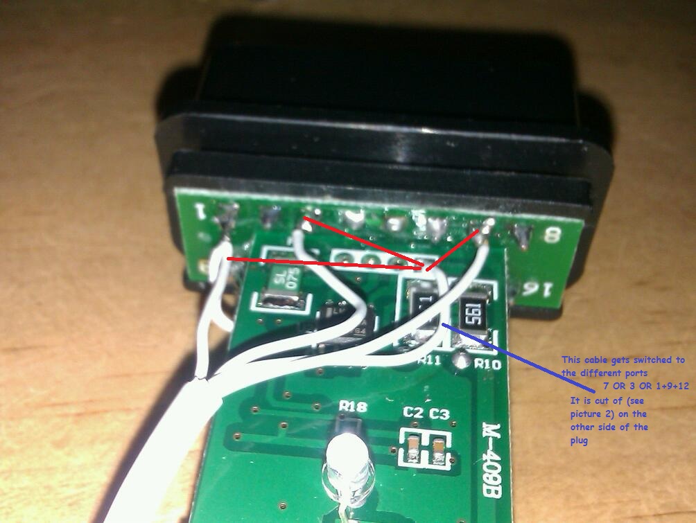

by kv99
Hi Eddy, all,
I tested again with a (much) faster laptop.
Same result: Can get to Engine and ABS but not to Airbag
Checked the VAG Kable again. It should be correct
Here are some pics.
Thanx Kalle
ports 1-8
ports 1-8
ports 9-16
ports 9-16
Re: can't connect to airbag via pin3
Posted: 04 Dec 2011, 09:17
by maunu
Have you tried to use the interface in different car?
The kkl cable and the modifications seems to be ok if the switch works. Switch/connection can be easily tested with multimeter. Set the meter to peep mode and connect to meter between pin 3 and J2 pin (round red dot in the picture). If meter peeps in pin 3 position then switch works.

maunu wrote:The kkl cable and the modifications seems to be ok if the switch works. Switch/connection can be easily tested with multimeter. Set the meter to peep mode and connect to meter between pin 3 and J2 pin (round red dot in the picture). If meter peeps in pin 3 position then switch works.
I tested that already and it "peeps" :D
