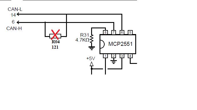

i have this interface and i've changed those capacitors with 2 560pF but still won't work.
anyone can tell me what is the resistor between CAN L and CAN H that i need to remove from the pcb??
thanks!

can isn't working. maybe there is an unecessary resistor between can L and can H but i don't know what it is

Here is the layout of ELM Electronics' should be displayed where these capacitors and resistors.
But I have yet had no ELM327 these components soldered into the
are needed.
The resistance needs to be removed. MCP2551 is in front of the chip (6 +7)
soldered.
If this does not exist.
Must be removed no resistance.
Otherwise, the connectivity problem is due to drivers or settings of the COM ports
ELM v1.5 R04 entfernen.jpg (17.71 KiB) Viewed 6797 times
