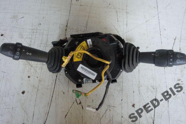

Hello, i have installed a rain sensor in a fiat stilo 1.9 jtd 150cv. The rain function works well, the wipers clean automatically, but the light one doen't work. I have activated the option with multiecuscan and now i see the option for regulating the sensor sensivity, but it doen't switch on the lights. Yani, could you tell me what is happening?thanks.

Rain sensor is a one. About "lights" do you mean about "automatic lights"?. If yes, than for this option you must have installed switch under steering wheel with 4 positions to switch off/on lights with icon "A" against standard 3 positions. Other wires from switch to body are needed too.

hi, i have the 4 position switch with the automatic light option. the problem is that the wipers switch on automatic but the light doesn't. I see the regulation option for sensor on the connect nav and in the left panel board near the stearing, but changes in this board or connect does not modified anything. Please Yani, could you help me? thanks.

Did you check there are wires from switch under steering wheel to Body unit?.If I remember there is one another wire for this.

Hi, i have checked the wires. When i have changed the body from año abarth one, it works. So i think it is a programation problem. Thanks.

Did you Proxi on your Stilo with Abarth dashboard?.

Now it is working with the new version.thanks
