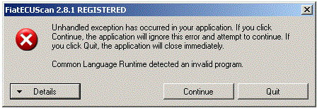

I just updated my 2.7 version to 2.8.1. Now I get the following message every time I try to start FES.
error message.gif (19.76 KiB) Viewed 5391 times
After I click OK, I get this screen and nothing more is happening.

The problem is in the version of .NET Framework which you have installed on your PC.
You need .NET Framework 2.0 with SP1.

I installed .NFW 3.5. Now the SW is working again! :-)
