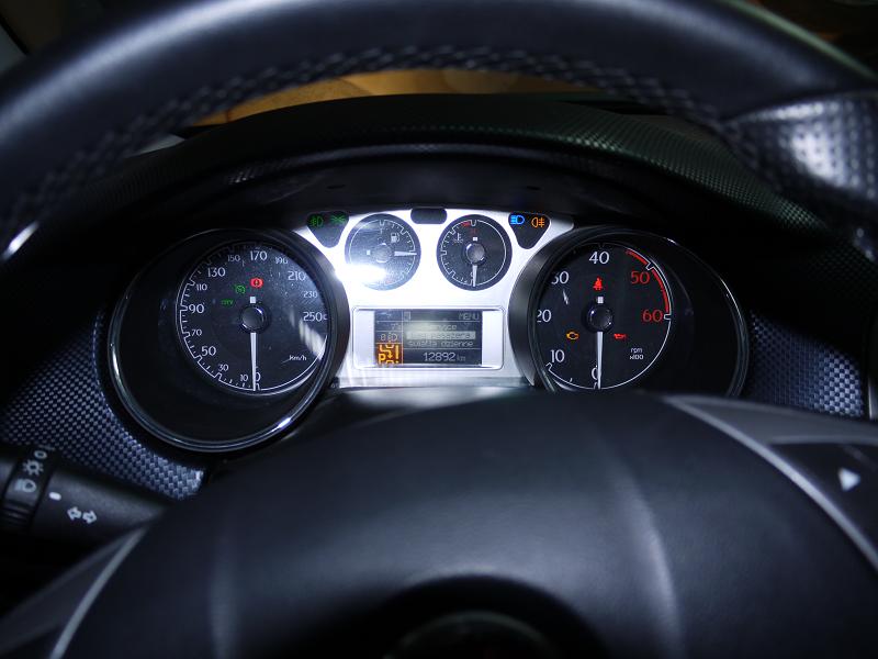

I changed a counter in Bravo with this from new Delta - extactly the same as there http://forum.stiloclub.it/viewtopic.php?f=120&t=27240. Of course my odometer is blinking. I went to Service Fiat to align proxy with new counter. There was a problem, because Examiner said that "option is over range" - whatever it means. We tried do this by Lancia and Fiat Examiner's menu. In Delta's counter was Blue Me and Parking Assistant connected, I haven't it in my car and I tried to alignment proxi to learn counter about that. Photo of my counter in attachment. There is blinking icon about Park Assistant error.

The same problem has my friend with Stilo. He mounted automatic clima where your car has a manual clima. Everything is working, but odometer is blinking and Proxi Alignment has the same error:
Writing to module: Climate Control Node (NCL)FAILED!
Kopia P1030010.JPG (60.73 KiB) Viewed 1212 times
