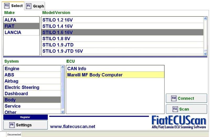

Select: Make>Model>System>Ecu
(in my case Fiat>Stilo>1.6 16V>Body>Marelli MF Body Computer - as shown on photo #1)
- FES-key programming 1.JPG (62.3 KiB) Viewed 30390 times

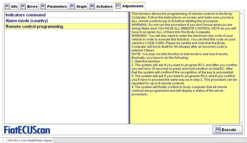

After that go to: Adjustments>Remote Control Programming>READ the guidelines on the right box (at least 2-3 times) as shown on photo #2
After that click: Execute and the one small window will appear. Just enter 5 digit security number from you CODE CARD and program will ask you to press "lock/unlock" button on the key. After you press that button you will if you have more keys press Y and if you do not have press N.
Exit the program and wait for about 15-30 seconds! Your key has been programmed!
Cheers,
Cheers,
- FES-key programming 2.JPG (56.91 KiB) Viewed 30388 times
