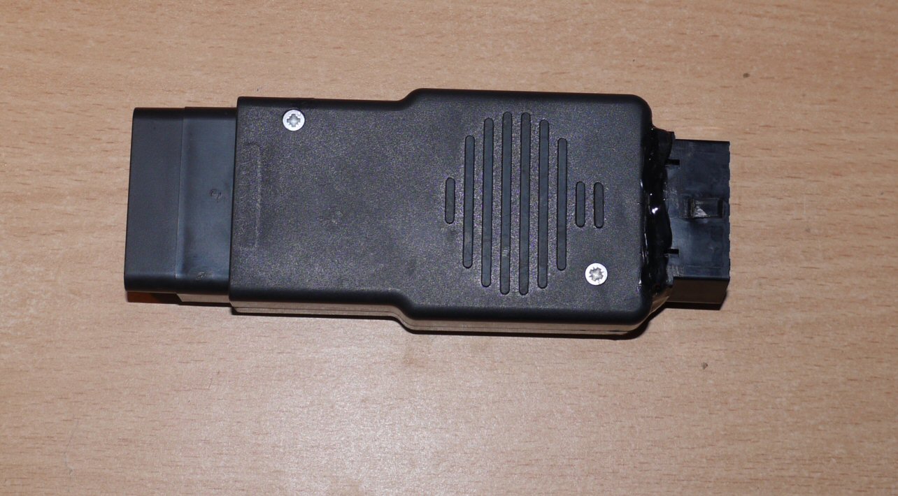

moviz wrote:Like the title, i ask to every one who know, where i can find and buy an elm c19 cable adaptor?? i prefer don't mod my original elm 237, but an adaptor cable is perfect!...thanks
Make it yourself. I searched few weeks in shops this adapter, sellers didn't understand what I want, etc. I bought male and female adapters, connected all wires, cut the cover, used a glue to connect two parts to one and now I have an adapter. In Poland female and male adaptors costs about 4 or 5 Euro. My ELM C19 adapter in attachement.
