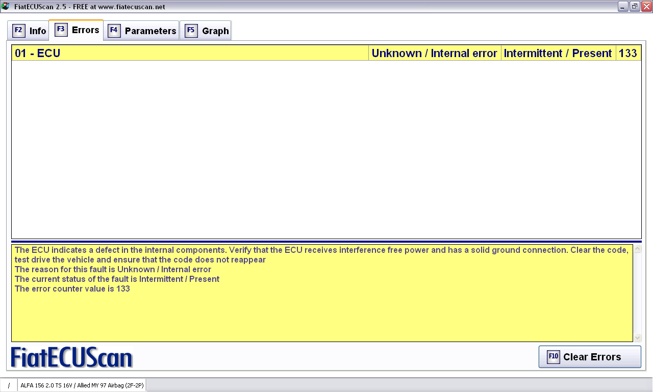

I use a mod USB VAG cable connected to my 156.
got a Airbag error. try to remove it but failed.
anyone know what is this error code mean?
thanks
Error code for airbag ECU

Try off the connector on the computer AIRBAG, contact spray to clean all the connectors and then try to undo the mistake.
PS. Before this operation remove the negative pole of the battery.
And if this fails the only remaining programming eeproma airbag
or replacement airbag computer.
