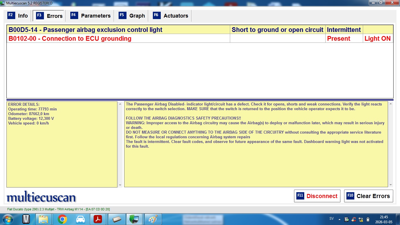

I had, what I thought, the EEPROM flashed by someone else.
I have codes:
B00D5-14
B0102-00
Couldnt find anything wrong with wiring or the passenger disable light itself.
With unit back in the van and warning light was off about 30 seconds or less. Started to input time, and warning light comes on and fault code in TRW unit is B00D5-14 again.
After a while B0102 comes on.
This is what I have in the fault code info though - with operating time on 77793 min - was the flash not complete?
