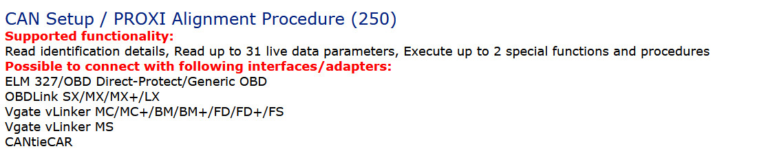

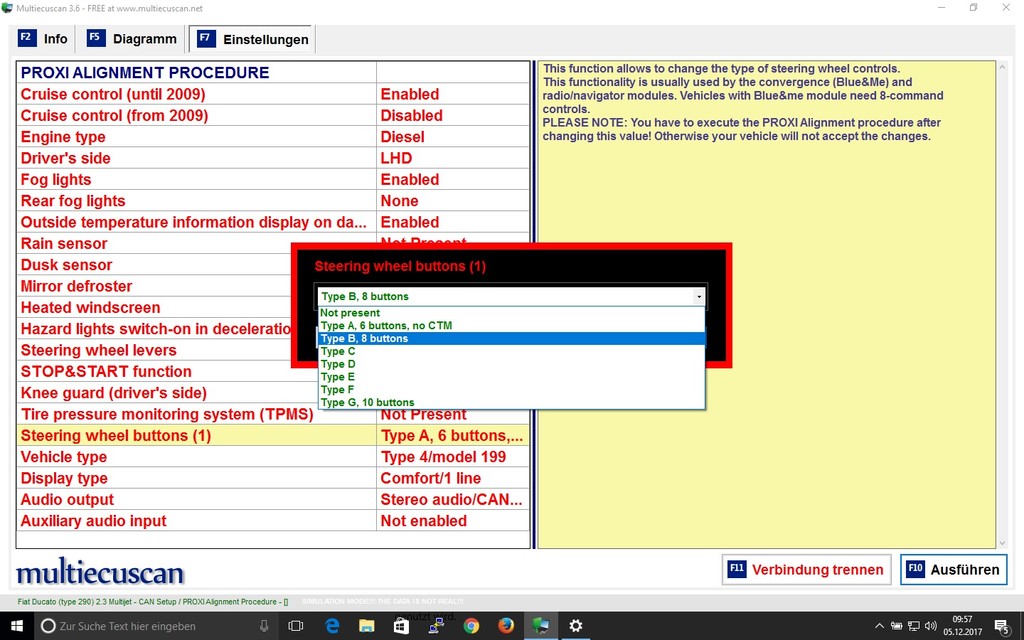

i try to upgrade my steering wheel with buttons controls. but i can't find the proxy aligment method to activate the buttons, like shown below.
from this german tutorial
https://www.wohnmobilforum.de/w-t126026.html
any help?

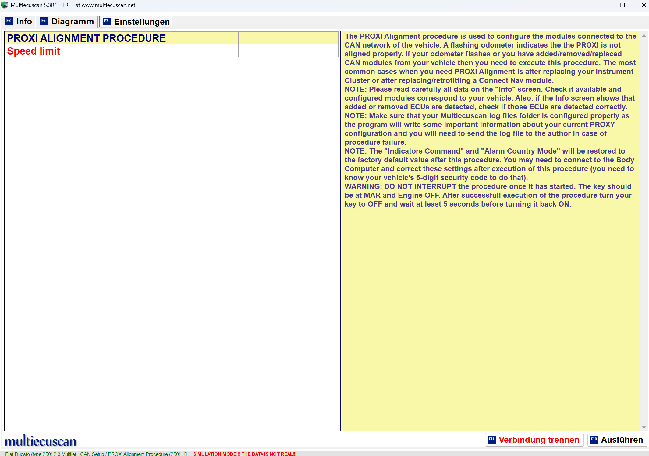

screenshot from proxy aligment procedure
where is this?
where is this?

show FESLog file what's inside?

mes doesn't support it?! right?!
kevin2008
Joined: 09 Jun 2025, 23:11
Re: Fiat Ducato 250 2.3 Multijet Steering Wheel Control Proxy Aligment
Post by kevin2008 »
buy licence. i m not sure, but not work with free version?
dennis_147
Joined: 28 Jun 2025, 14:49
Post by dennis_147 »
Screenshot is from my Workstation. I use a Notebook with registered MES Version, but it is the same
