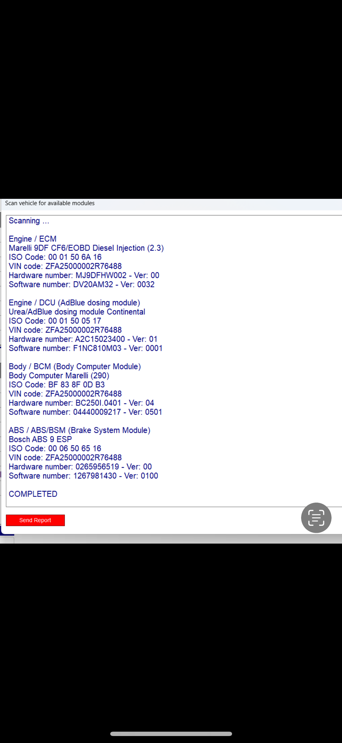

is anyone able to confirm if my 2020 reg plate (feb 2021 manufacture) actually has no SGW? it’s 2.3 multijet, ad blu.
i’ve stripped the dash and the glove box area has no physical module.
i’ve connected using a Vgate vlinker MC+ to multiecuscan5.3R2 direct to OBD (free version) and the scan DTC report doesn’t mention anything about SGW.

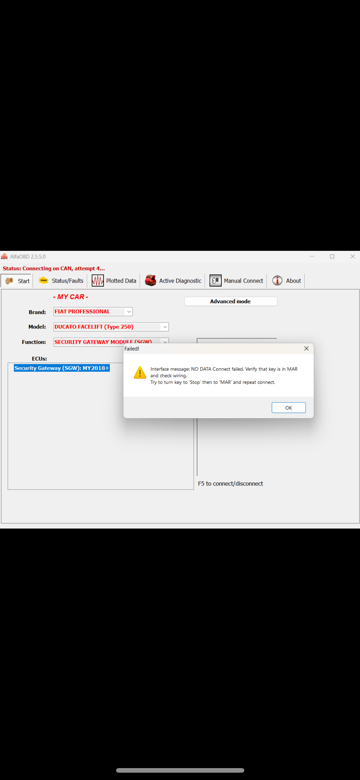

also tried alfaobd and this won’t connect to an SGW module.
does this mean my van is without?

see photos of my two (free) scans.

Some later models of the Ducato (and other vehicles) have the SGW integrated into the Body Computer (BCM) and there is no external module that can be bypassed.

hi mate.. yes i’m aware of that, but if that was the case would the DTU scan list that it has an SGW? how would i know its built into the BCM?

you can always try by running some tests like turning on lights - if it allows to do it, then no SGW is present.

Exactly what Shpuncik says. The 2020 manufactory date Ducato (2.3, 9hp gearbox, adblue) from our company doesn't have an SGW.
