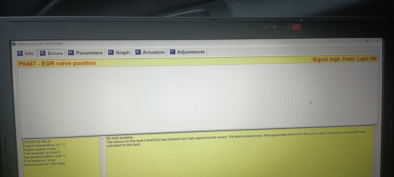

Thanks a lot for your answer. You're right, let's focus on the basics, and step by step.
The injectors codes are OK. Engine Programmed and startup allowed. See attached pics if you see sometings odd by your side.
For me not much, except the blocked EGR error and Flow shutter valve test Failing to execute (not even sure there are swirls on the engine though).
I'm not a diesel specialist, and more confident with bikes or carbs engines, but it sounds like the engine starts a few seconds, maybe 4 sec. Hardly iddling, if I give gas it's worst, and it stops after some seconds. Now I have the feeling the engins chokes, probably not missing fuel, but air...
I have received a new EGR valve, will change it and see ...
Thanks for your precious help!
Re: Fiat Bravo won't start after self learning reset
Posted: 17 Apr 2025, 20:31
by abarthmultijet
Hmmm if it is an air measuring problem, you can disconnect the MAF sensor. (round tube with sensor directly after air filter) The car will go in a sort of worst case MAF senario, it will start and run but will throw an engine code.
An stuck EGR can cause a crank no start!! Have read lots of wierd stories with an stuck EGR.
Maybe the car knew the valve was stuck open and adapted to it. When resetting the car "forgot" that the valve was stuck open and no longer runs. Think this is the thing you need to check first.
