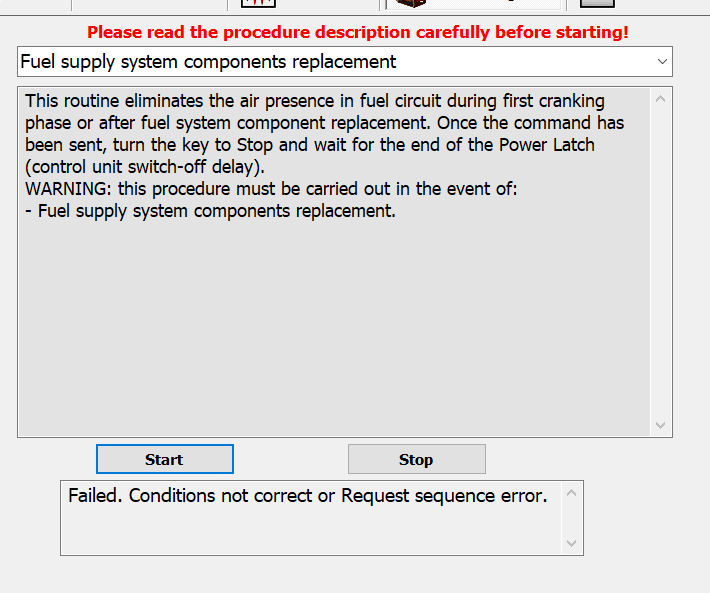

I tried on AlfaOBD but I can't run the procedure, screenshoot attached
