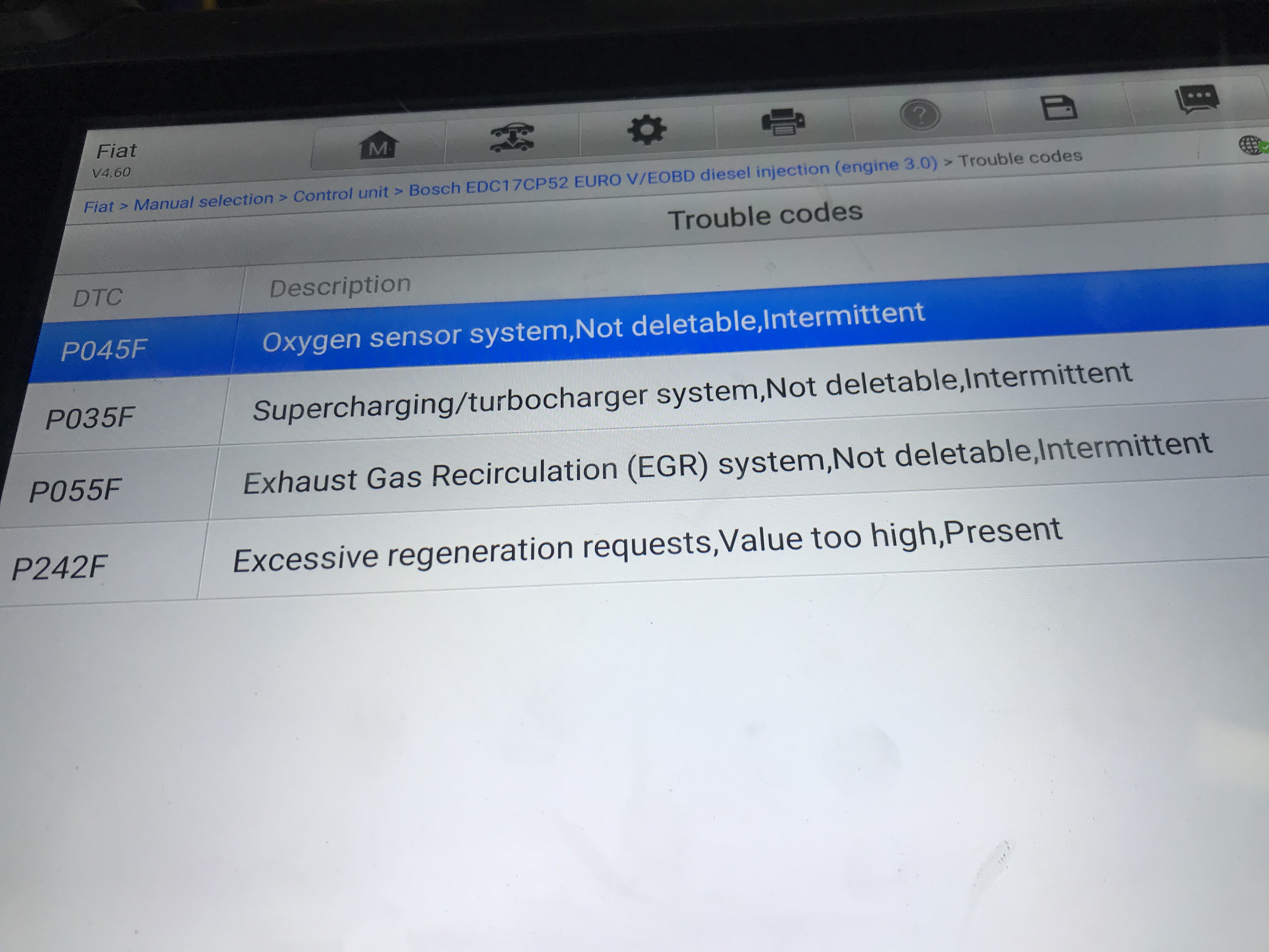

Hi all, can someone tell me if the Autel J2354 devie will work with this software if i purchase it , we use autel for many of our 80+ vehicles, but the autel device has some major isses speaking to fiat vans

Never tried it, but I don't think this device will work with MES. Probally best to buy an genuine ELM327 or other know to support dongle.
I use Cantiecar dongle and never had any problems and no need for adapter cables.

thanks for the reply, have just ordered one that says 100% compatable elm 327 for multiecuscan, my issues are i cannot clear codes using a autoel maxi sys device, t
he error codes come up like this
awe have replaced the dpf but just cannot tell the ecy we have done so

Ok great. Maybe with ELM it is best to also buy the colour adapter cables. If you need them you have them you got them.

thank you, i have ordered this, do you think this will enable me to remove these problems ?

Yes. Pretty sure it will. Keep me posted
