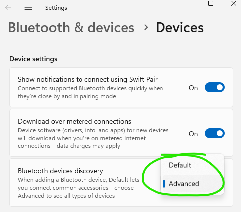

When trying to pair the vLinker MS Device on WIN11, please be aware of a special settings of Windows Bluetooth which is, by default set (not surprisingly) so it will not detect the vLinker device.
Before searching (pairing) the vLinker device please:
1) go to Settings > Bluetooth & Devices > Devices (same window where you pair)
2) scroll down to "Device settings" section
3) switch "Bluetooth devices discovery" do "Advanced"
4) scroll up and now click on "Add device".
Now you will see the vLinker listed as available device, as described in the user manual.
