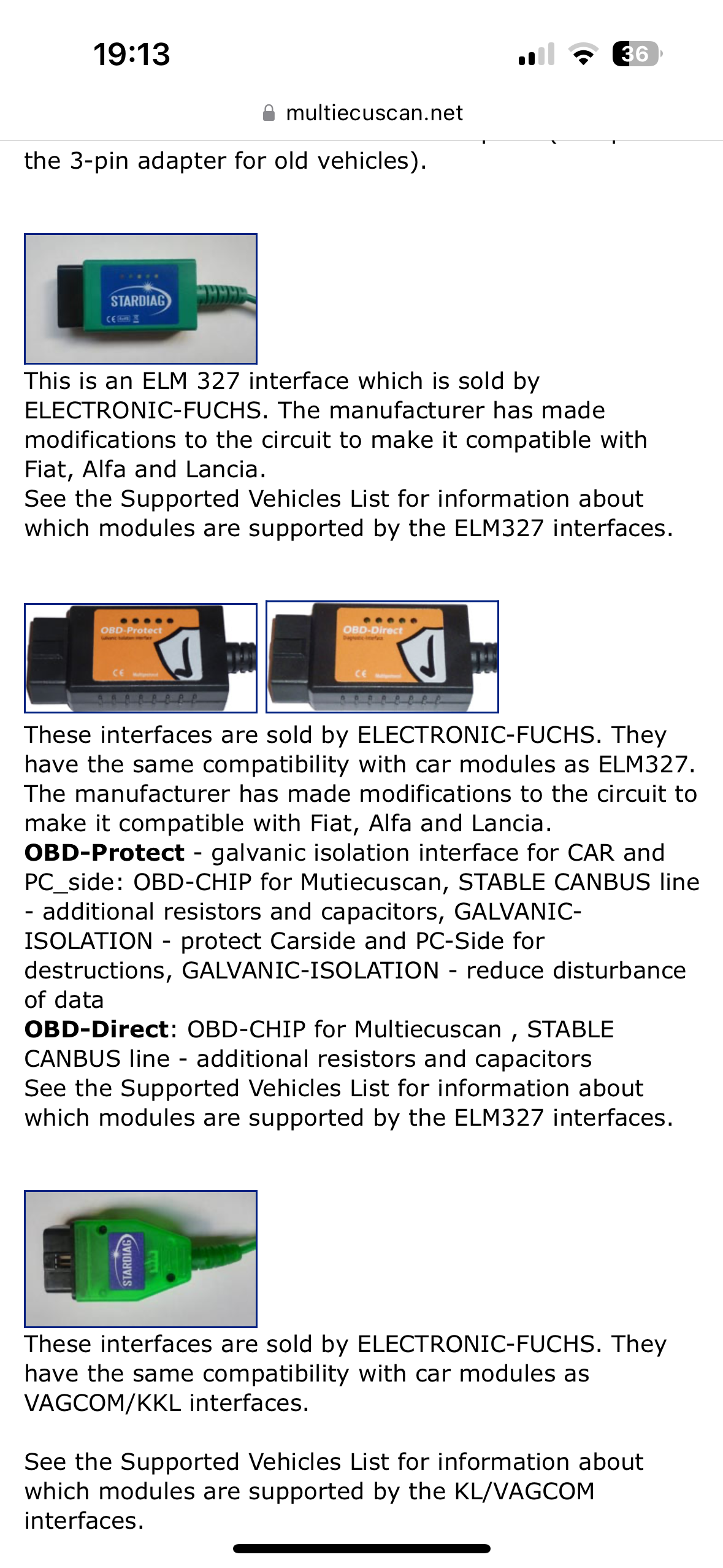

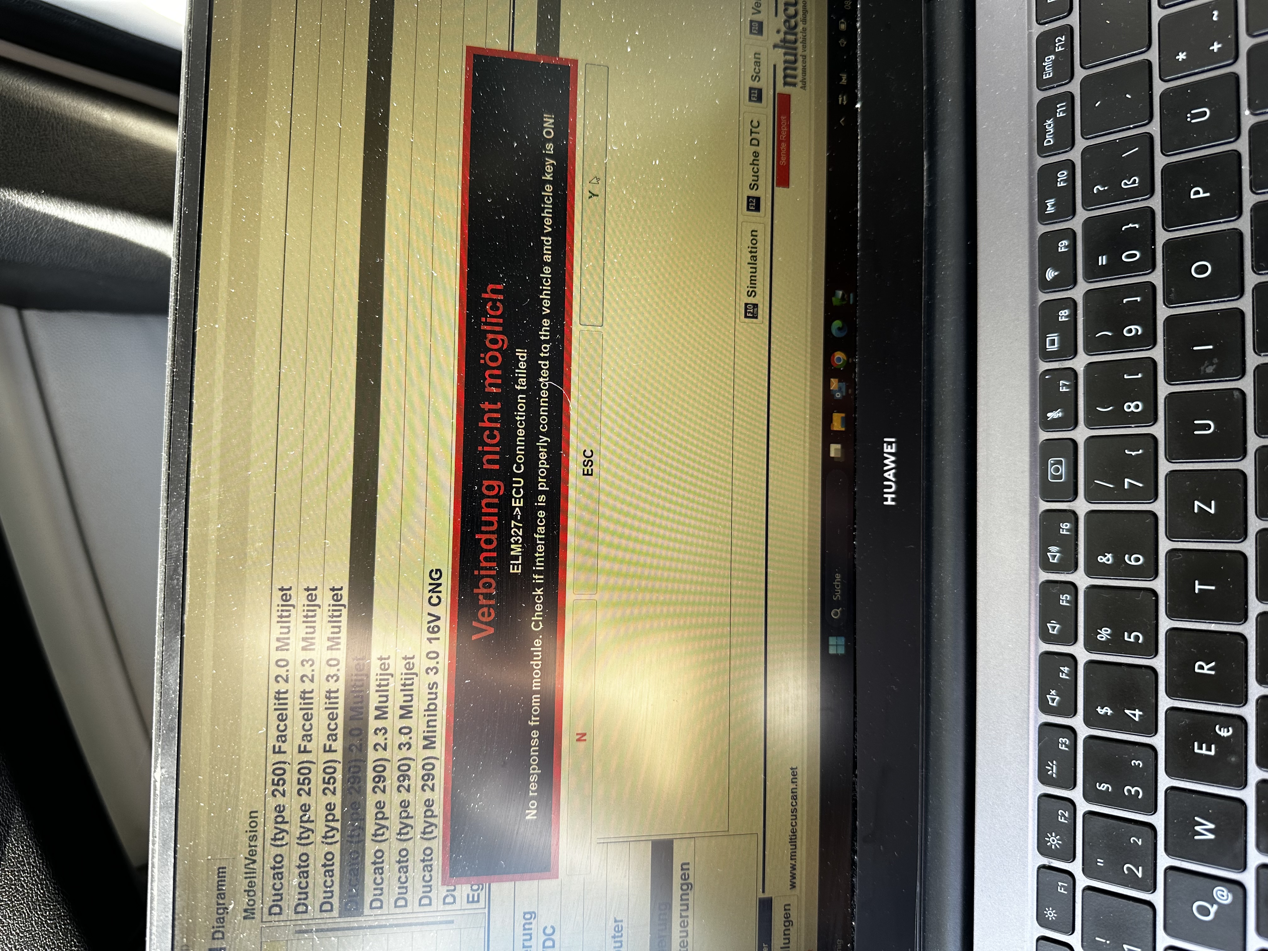

When I try to connect to the control unit with my interface (ELM327 - ELECTRONIC-FUCHS) and the prescribed yellow adapter, the following message appears after a short time: "ELM327 -> ECU connection failed".
All other control units can be controlled.
Can someone tell me what I'm doing wrong?
