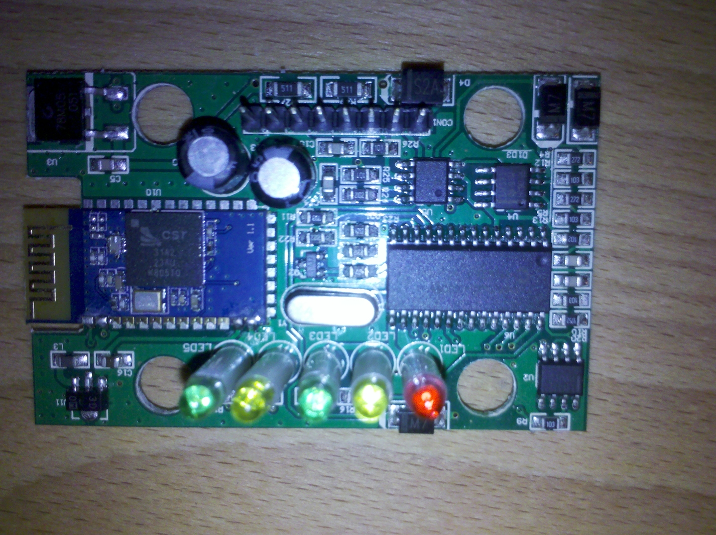

Hi everybody, i have some problems with my BT ELM372 interface.
I want read my car statistics (FIAT BRAVO 1.6 mtj 120cv 2010) with Android Torque. I pair my BT ELM with my smartphone, and everything is ok, but Torque says that he can't send OK command to ECU. It seems that he can't communicate with the ECU. Additionally if ELM stay attached for some minutes an AIR BAG FAILURE message appear. The message disappears after some time. I don't know what i have to do. Please help me!
This is the PCB of my ELM327:
[img]
[/img]
[img]
[/img]
Thank you so much for your help!
Posted: 20 Oct 2013, 19:31
Hello Wizzy87
Your error probably has nothing to do with the board.
because
- Only Multiecuscan has the connection problems in the CAN bus
- The ECU will not read your Bravo with CAN bus
- Your ELM interface does not have this bridge resistance at issue in this thread
- With Torque I know I not good
- To the airbag light on your program tries to comunicate If your tests with the airbag control unit. This should not happen.
Maybe your ELM interface is broken or torque can not read your Bravo.

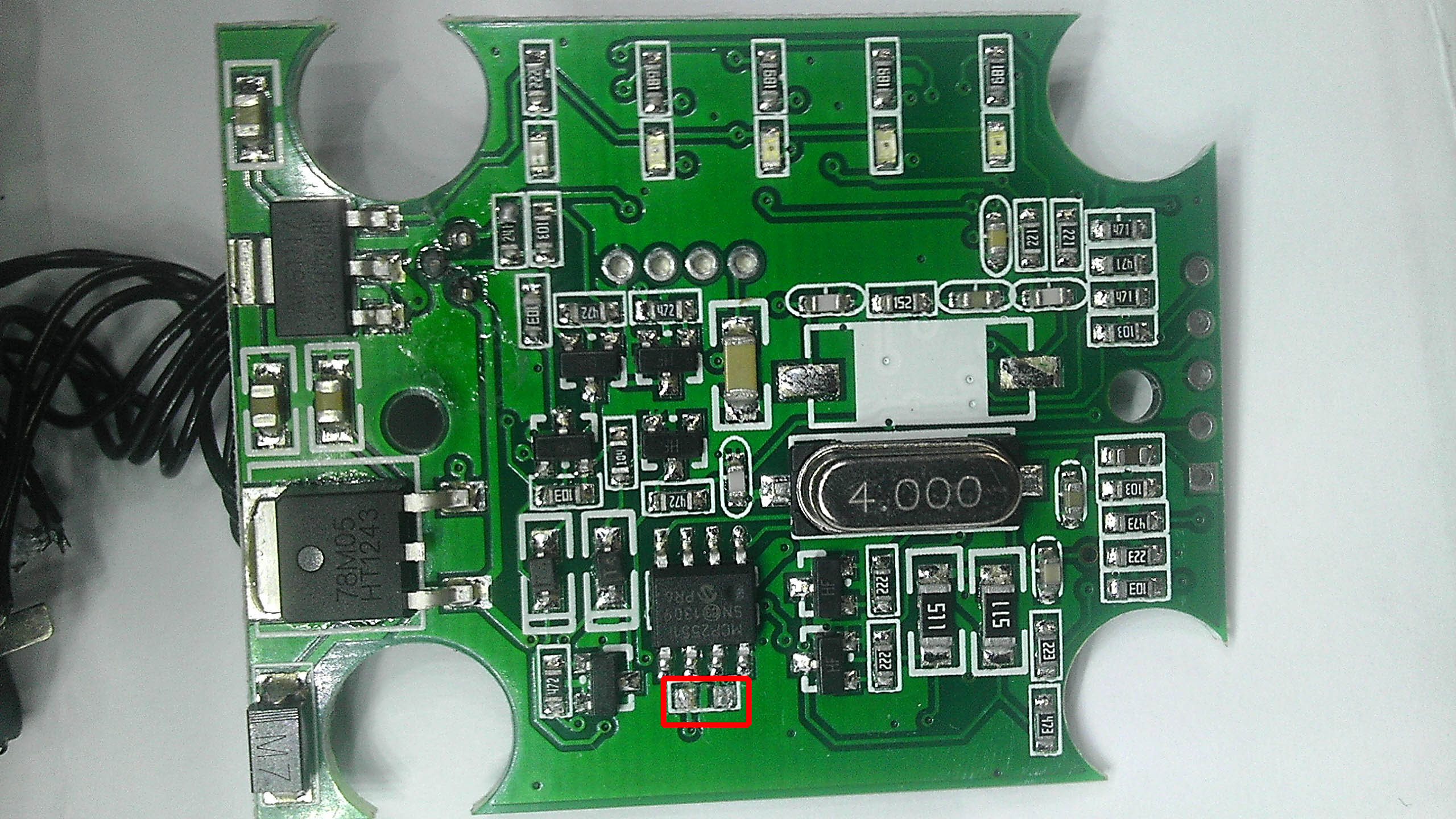

I've removed R04 from my BT Elm327 as instruction found in here, but still not connection to ECU. My car is Toyota Axio X 2008 and HTC EVO 3D try with Torque Pro and DashCommend. attached are image
Please help.

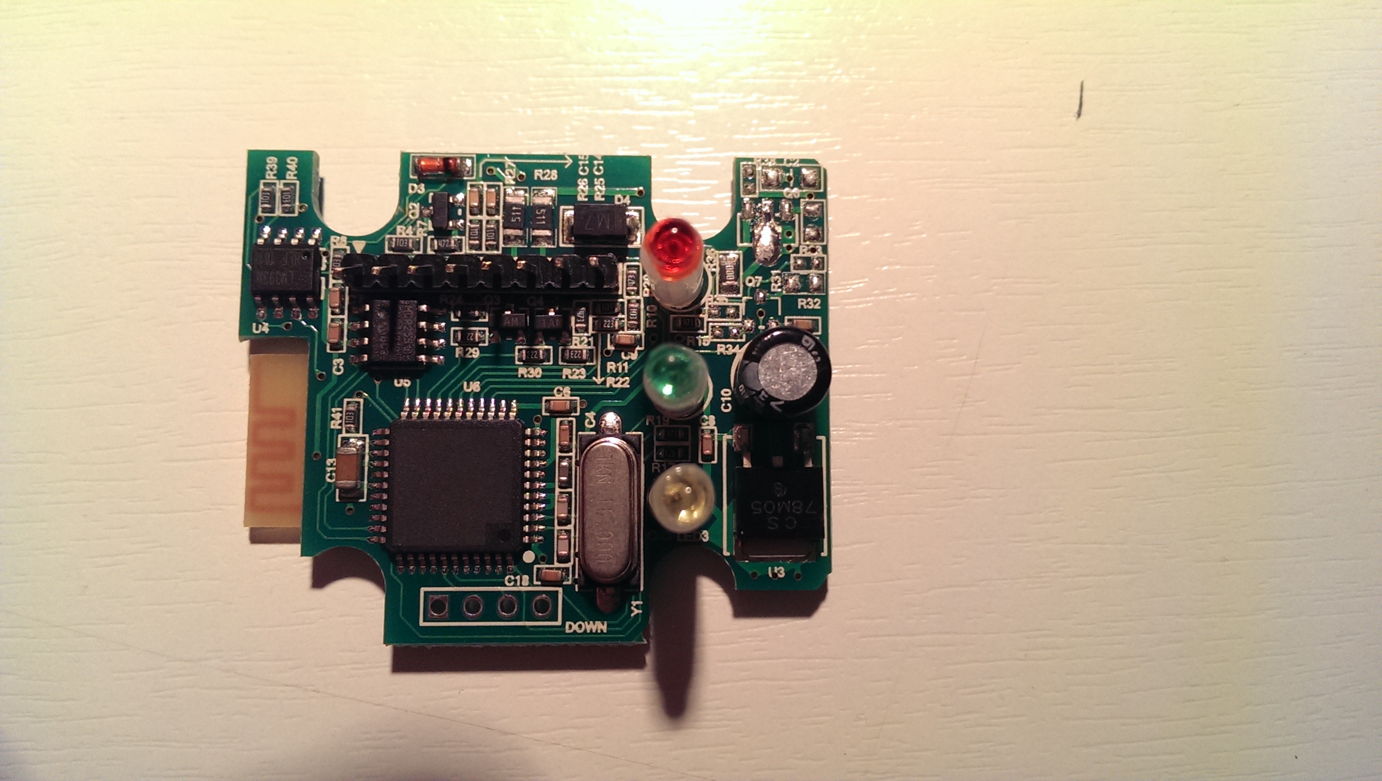

Hello Eddy!
I'm from Hungary. I have an ELM327 Bt.
My problem: Can't connect to ECU
(Vw polo 99, Golf 2000, or any vw)
Programs: torque, carport,..usw)
Should I take the r04 off? or is any way to connect it to VW?
Please, help me. (Pic from the elm)

Posted: 26 Oct 2013, 19:54
skt3d wrote:Hi Alfaeddy,
Please help.
[img]
[/img]
djfire wrote:
Hello Eddy!
[img]
[/img]
Hi Guys
Here in the forum, more and more people report problems with the connection of the
Torque , Carport , ec. have diagnostic software to other vehicle manufacturers.
Here in this forum, it goes exclusively to
Multiecuscan
This software has been developed for Italian cars (and Suzuki SX).
It's no easy to remove any resistor And hoping for the connection works.
You may not believe your Torque, Carport, ec. software on each and every vehicle works.
Therefore, I will no longer respond to these posts. !! ;) ;)
