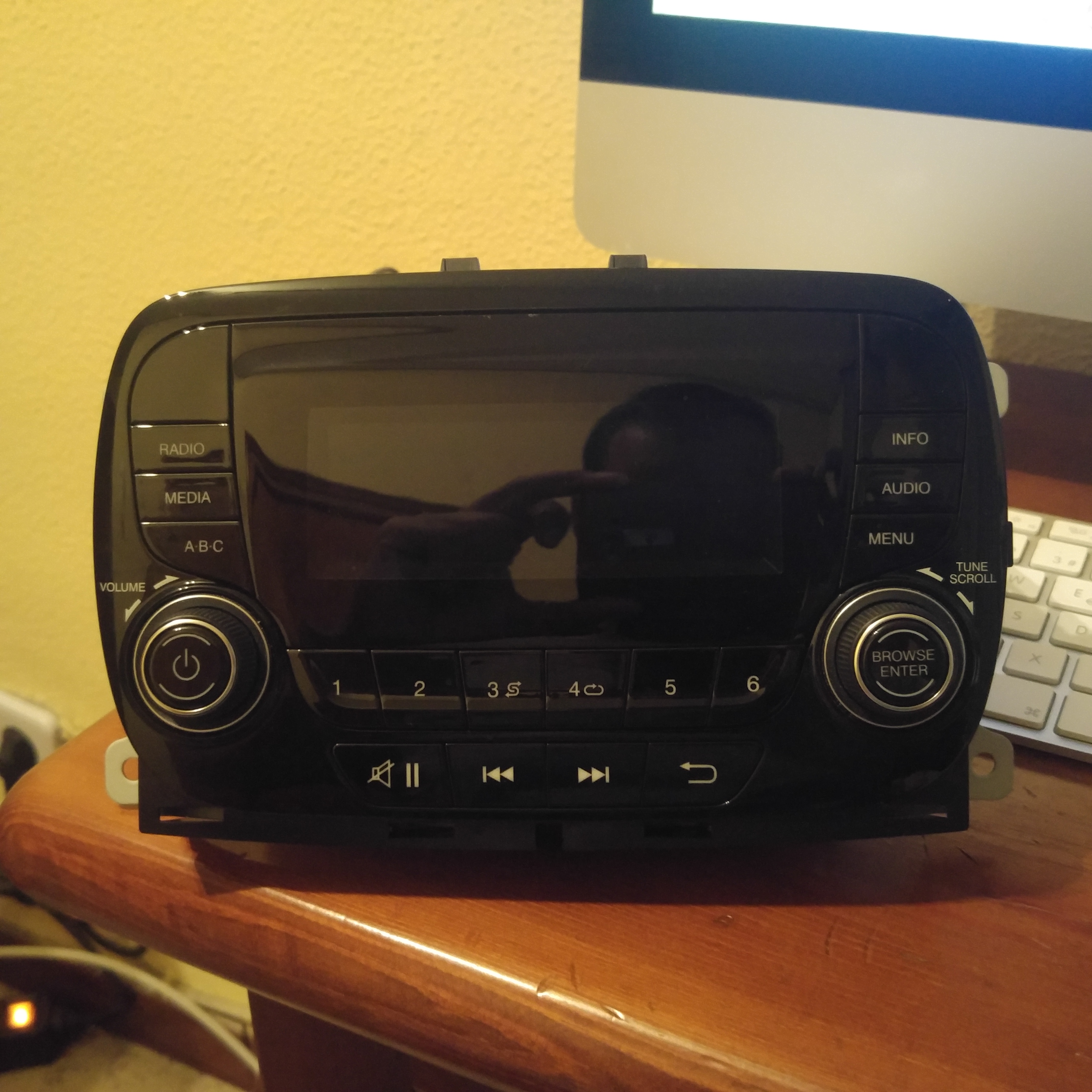

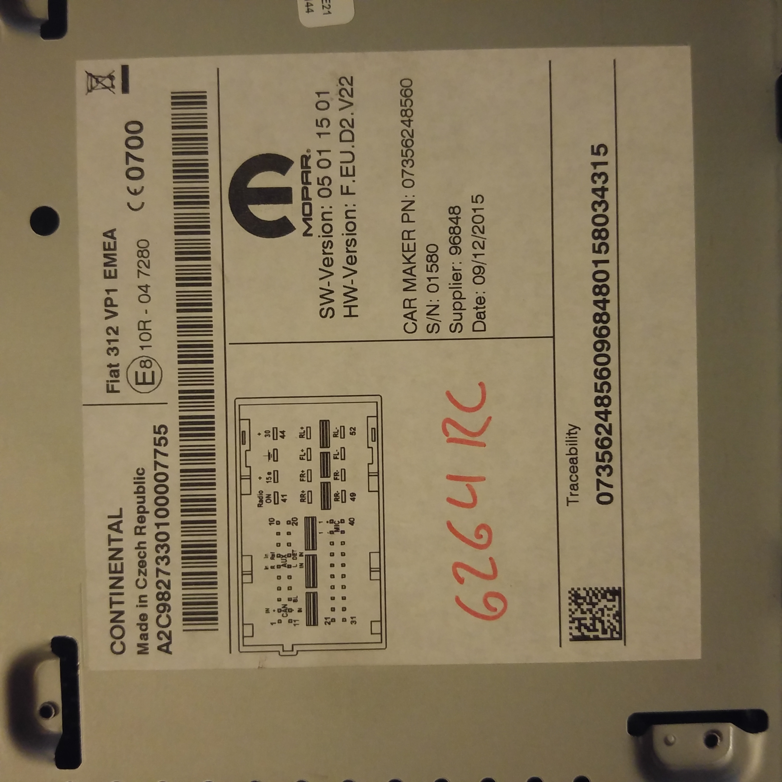

hi to all,
i will like to know if its posible to activate the missing functions with this model of radio?

by alex-et3
Hi!no,only with uconnect 5 or 7hd

by ja_bacardi
alex-et3 wrote:Hi!no,only with uconnect 5 or 7hd
thanks, i`m having the same trouble everyone else with the missing menu.

by alex-et3
This happens because you buy the wrong speedometer ...

by ja_bacardi

by alex-et3

Yes i realized that after reading this thread, but i wonder would it be possible to plug the analog speedo through the obd plug like the uconnect?
No, because the digital speedometer was born to dialogue only with the uconnect.
