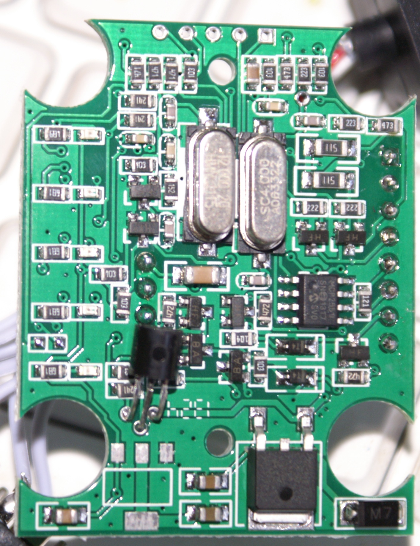

Hello, I am new here and I just got myself an ELM327 module from eBay and tried on my Fiat Linea. And I have trouble viewing the CAN section. I see all the symptoms mentioned in the first post, like all Tests return 'OK', I can access the engine section but nothing else. I must also add that I am using the Free version but have plans to upgrade to the Registered version. But before I spend any more on this, I wanted to resolve this and make sure that the ELM module I have is alright or needs to be fixed as mentioned in this thread.
BTW, the board doesn't look like the ones posted in the first few pages. I have very small LEDs and I don't see anything like R14 at all. Thanks for the help!

You need to show that interface to Alfaeddy
Posted: 04 Sep 2013, 20:03
Most ELM Interface are now described here and I have liked the bridge resistors on the interface problem.
Either search in posts or make a picture of Repeated

by Jay_in
Alfaeddy wrote:Hello
Here's the best shot I could get with my 8 year old camera.

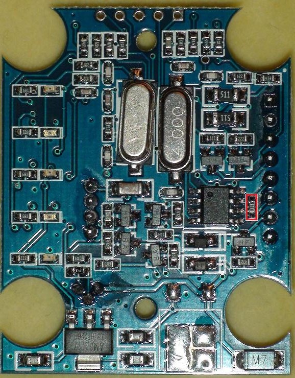

Posted: 05 Sep 2013, 10:25
by Jordandc
Here is similiar. You need to remove red marked resistor
Posted: 05 Sep 2013, 12:06
by agila
Eddy everything is working after removed this resistor.

Posted: 05 Sep 2013, 20:13
by marinozacc
Alfaeddy wrote:ello Agila
Remove the red resistor and let this place open
it is the interface with CAN bus capable Multiecuscan
alfaeddy
i've the same elm 327 mini and it worked right on ford fiesta and alfa 147 1.6 120c, but not on fiat punto (188) 1.9 jtd (I tested with torque first )... now I removed the R04 121 but it not work on punto and alfa..

Posted: 06 Sep 2013, 12:08
by Jay_in
Jordandc wrote:Here is similiar. You need to remove red marked resistor
That worked like charm. Thanks a lot!
