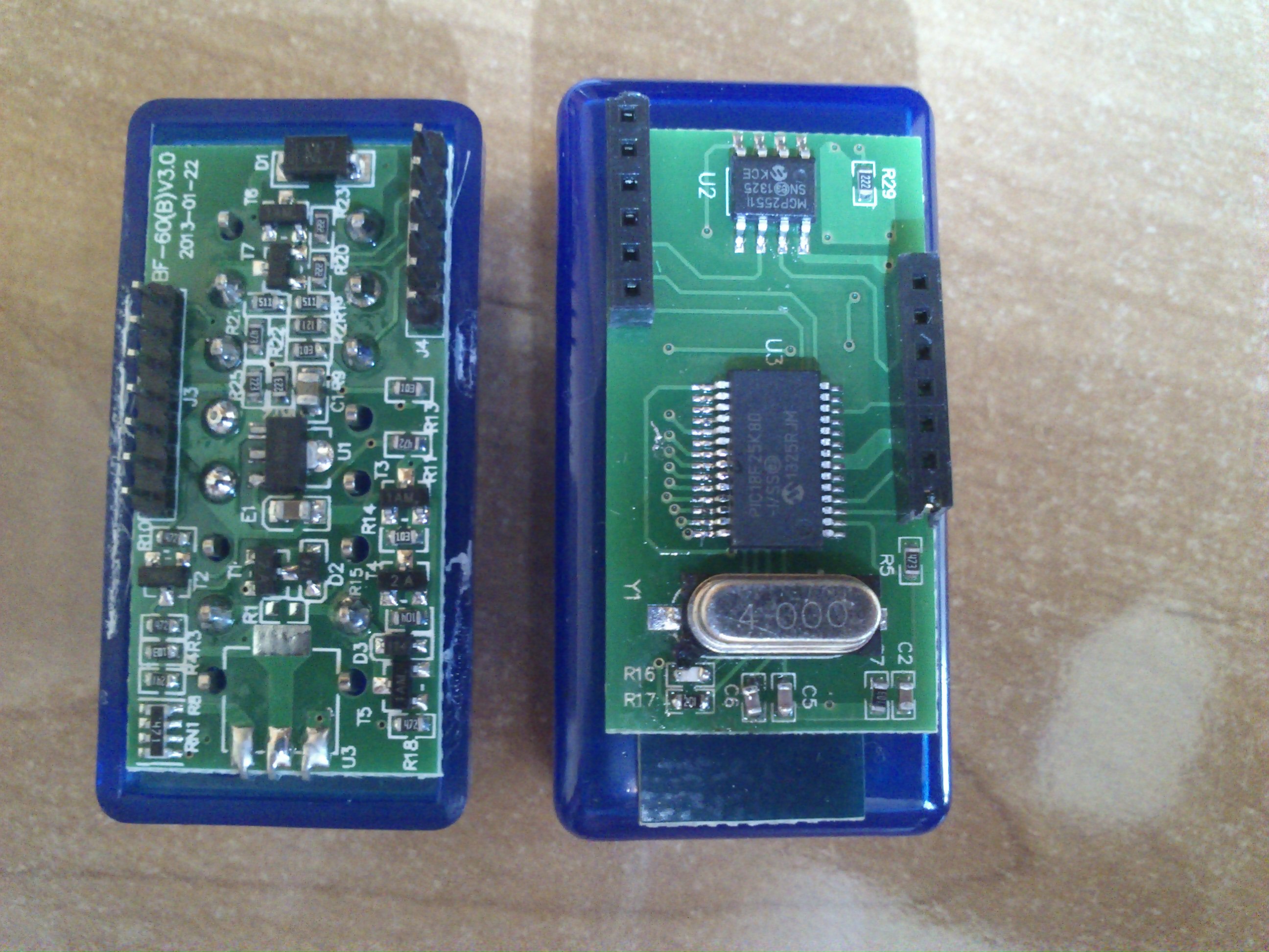

I found that many of these devices are based on the same, incorrect, PCB layout. This layout contains a mistake which means that the J1850 interface doesn't work.
They have the T5/T2 transistor tracking fault on PCB which in other models can easily be removed, but in these small adapter that is not the case.

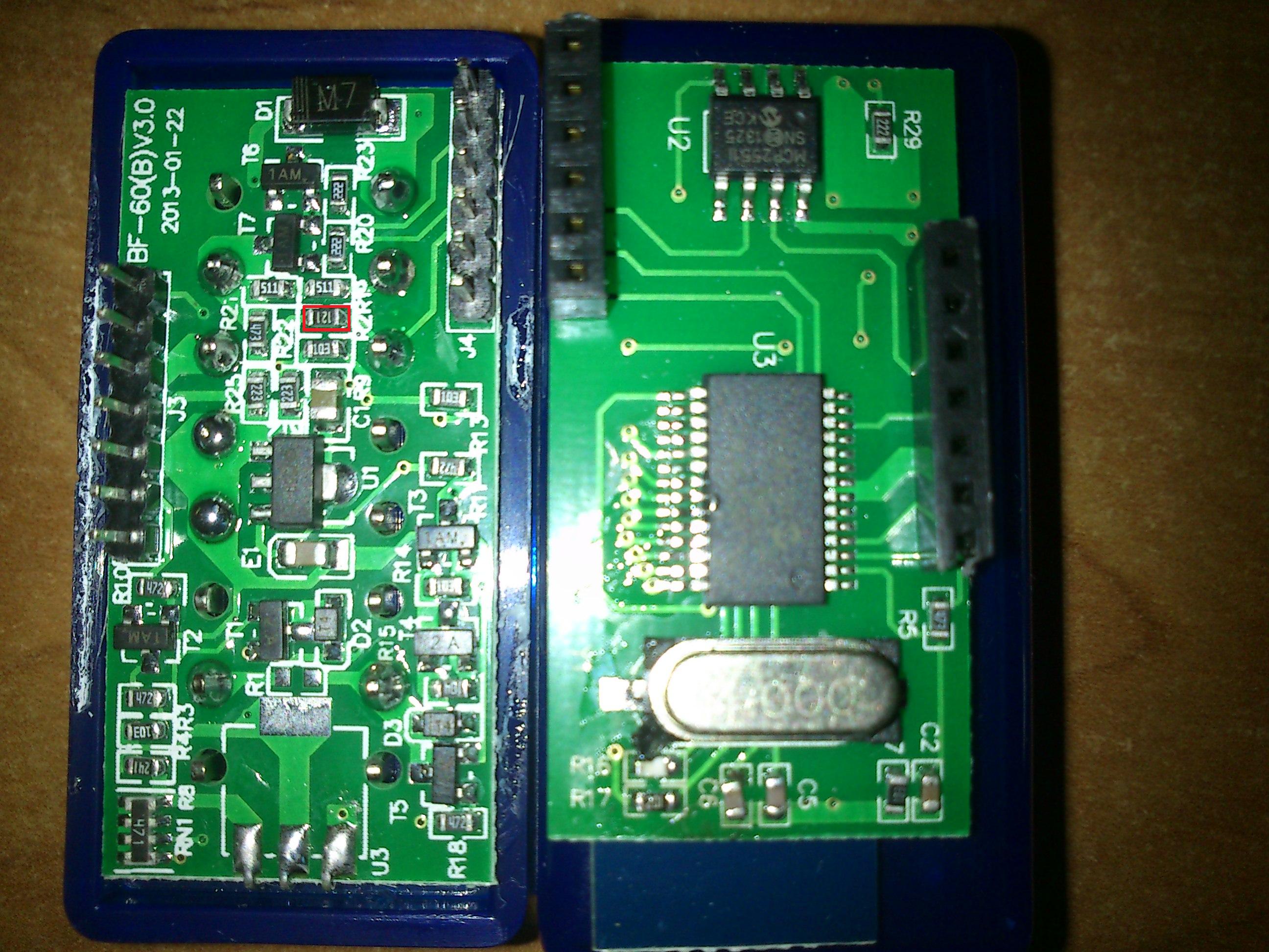

Hi Friend.
I have a trouble problem with connect my elm to grande punto 1.4 8v. It's connecting just engine. I also own yellow adapter but still no luck.
this interface Image
this is interior of interface
ello Agila
Remove the red resistor and let this place open
it is the interface with CAN bus capable Multiecuscan
DSC_0343[1] markiert.jpg (637.56 KiB) Viewed 9278 times
agila
Joined: 04 Sep 2013, 09:54
Post by agila »
can i use wallpaper knife to remove it I dont own soldering iron?
